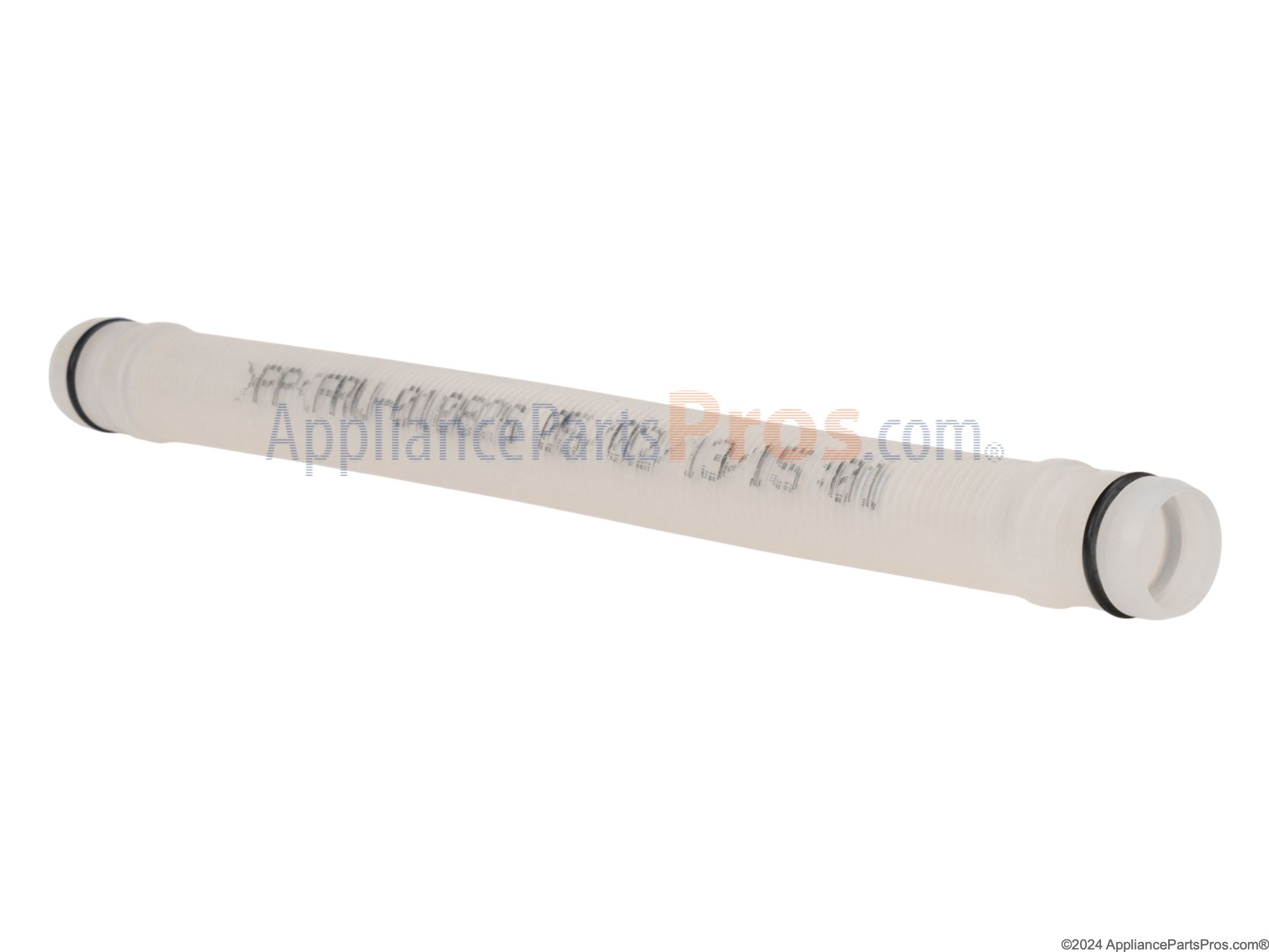

Wilbur C Washington , DC October 13, 2014 Appliance: Bosch SHY66C05 UC/14 (FD8301-) Low water pressure / arms not spinning Used vids on youtube for steps on how to disassemble and install the pump; search "Bosch dishwasher circulation pump replacement". Also on AppliancePartsPro forums, a poster put up the Bosch "Dishwasher Service Training Manual" in .pdf. Search "Bosch dishwasher low pressure" on the forum. It's one of the post with the longest thread. Six pointers. 1. In another forum post, the poster noted that some hoses were brittle with age - and cracked when reinstalling. I had same issue (my washer is ten years old), but forewarned had ordered the two hoses. These are Bosch PN 361113 and 263099 (I have a SHY66C05). You disconnect and reconnect both these when installing the new circulating pump. My 361113 was also brittle and I could not get it reinstalled. Plastic deformed when I tried to reinstall. Swapped for new, which went in like butter. Other hose I did not end up needing. Order these and return if not needed. Other poster had to wait another day to get the needed hose in. Super aggravating to have to wait to reassemble. Wife also will not be happy. 2. On the pump outlet side, there is a one time use hose clamp: this can be reused, but take care not to deform it taking it off. I had slightly damaged mine, reassembled my washer and it leaked from this connection. Then found that my local hardware store did not have narrow clamps, rebent mine to close to original condition, re-installed, and luckily it worked. If I knew that I was going to re-use it, I would have been more careful getting it off. Use two flathead screwdrivers. There's a raised part on the clamp (where a normal clamp would have a screw). Push on this raised part to tighten - to release tension on holding pin. Use other screwdriver to gently pry up on the clamp's lip that's engaging the holding pin. This unfortunately may take three hands - a helper may need to hold the pump assembly while you use the two screwdrivers. 3. There are 10-12 different kinds of screws across the different disassembly steps. Get a muffin pan and use a separate compartment for each set of screws. Or lay out a dozen post-its and put each set of screws on a different post-it. 4. All the screws are T-20 torx. If you don't have a dedicated T-20 torx driver, you may need one. I had a multi-head driver with torx, but the shaft was too fat to fit in the opening to remove the front kick plate support. Caused me to go to hardware store before getting 5 minutes into the disassembly. If you don't have a dedicated T-20 driver, get one before you start the disassembly. 5. Agree with other poster, wear gloves when working with the stainless panels - edges are sharp. 6. Run a couple times before totally reassembling to make sure that there are no leaks. I didn't do a full cycle, buttoned it back up, then had "flood" condition - where drain pump runs continuously even when door is open - because of standing water in the pan. Had to disassemble a second time. Four possible leak locations... going from right to left (while facing front of washer). Circulation pump inlet and outlet (another poster - a bosch repair person said that these are the culprit 7 of 10 times), drain pump, and water supply/management assembly. Each of these four locations have low points on the pan; so get a good flashlight, watch these low points, run the dishwasher a couple times to make sure no leaks (I ran mine twice, then buttoned it back up). Read More... 45 People found this story helpful Do-It-Yourself Rating: Repair Time Estimate: 2+ hours Tools: Screwdrivers, Wrench Set

Paolo S Farmingdale , NY April 28, 2015 Appliance: Bosch SHV99A03 UC/14 (FD 8212-) Internal water line was leaking After identifying leak in hose and some searching for access to hose. I was able to get to part that needed to be replaced. Ordered from appliance parts pros (two say shipping because my wife could not bare to be without dishwasher for longer) with help from their customer service to identify right part, as there were two very similar parts. I was able to get parts and fix machine reassemble with in 45 min. Fantastic and saved real money without having to call repair service! Read More... Do-It-Yourself Rating: Repair Time Estimate: 1-2 hours Tools: Screwdrivers
