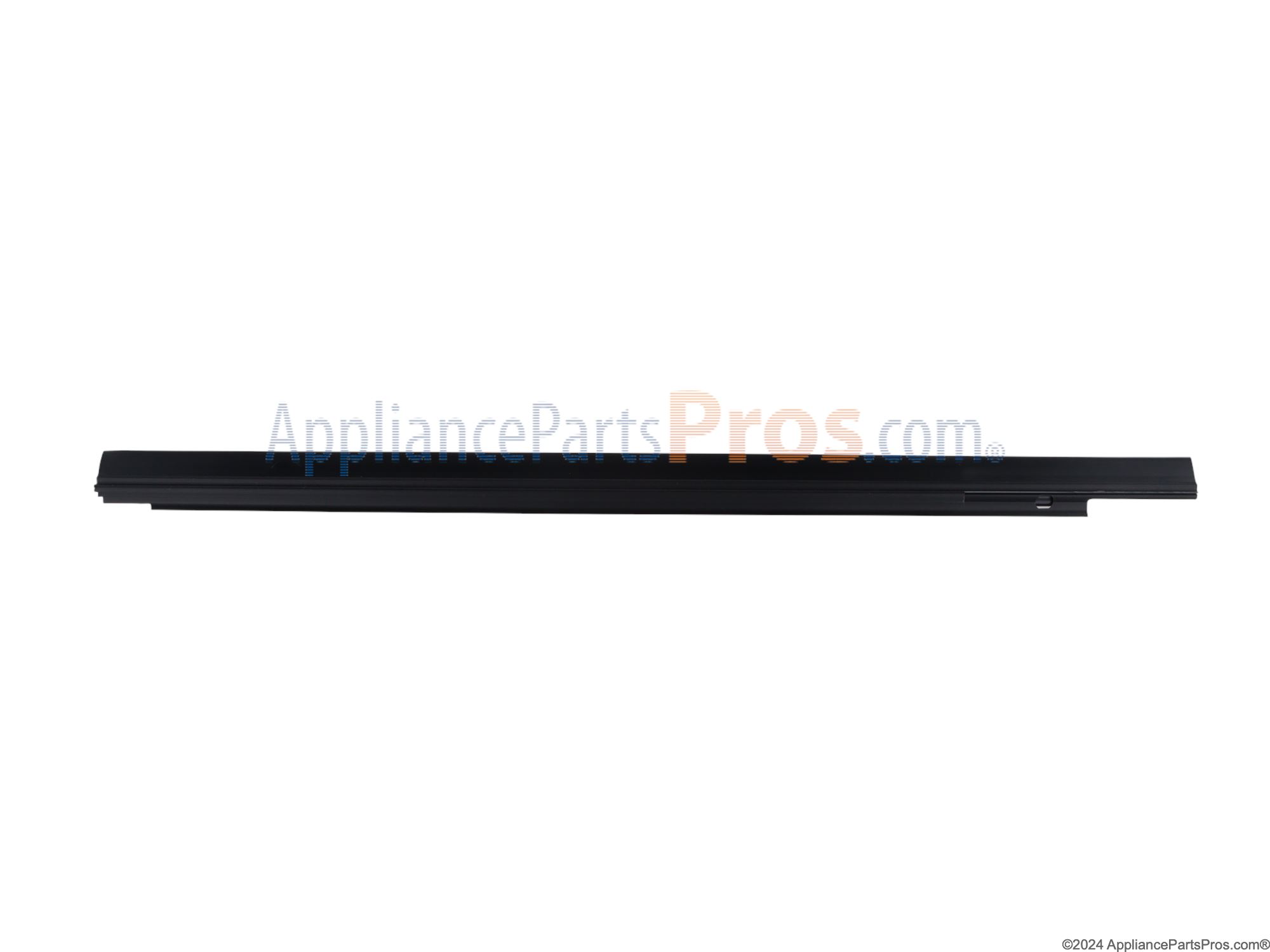

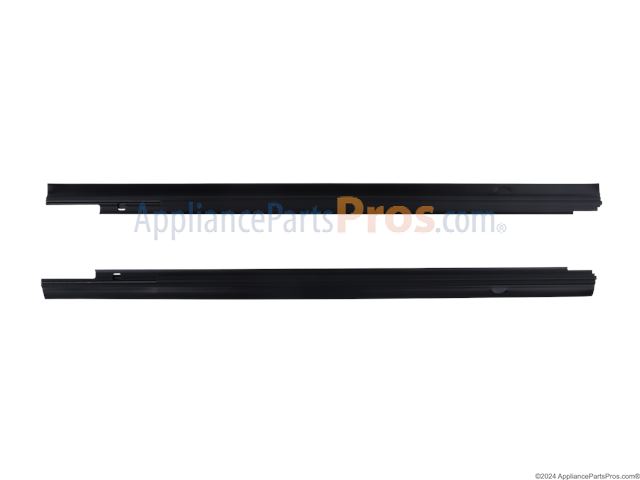

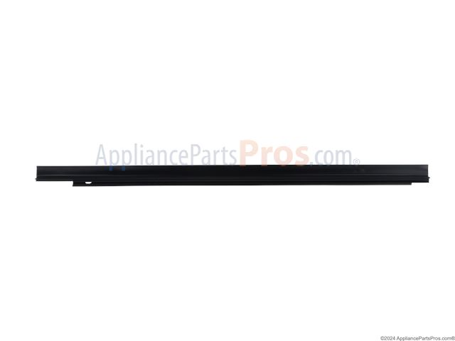

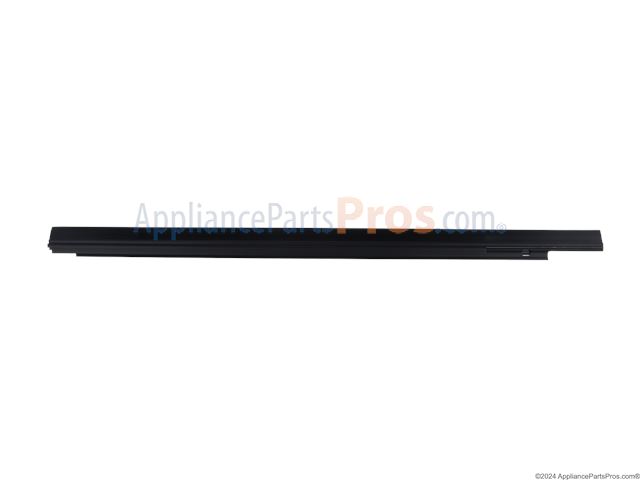

Cynthia F Hilo , HI February 02, 2020 Appliance: Bosch Dishwasher SHE68T55UC/02 Door not holding close and leaking water Replaced the springs and due to age, went ahead and replaced side & top strips and door gasket. The challenge has been leveling the machine and making sure the gasket actually works (there has been leakage but we noticed the gasket at the bottom was straight and it seems to fix the problem). I think it will take longer than a few moves up and down for the gasket and trim to form a nice seal with the door. The cleaning of the appliance took the longest and I went out of my way to do additional stuff that was technically not part of the overall repair (I noticed in your videos, nicely glossed over). But anytime I pull an appliance out, I do extra deep cleaning in the back and inspect around for any other issues (like unwanted insect nests). The actual overall repair was about 30-60 minutes and included watching the very useful videos you have online. (by the way - the videos are excellent!) Read More... 3 People found this story helpful Do-It-Yourself Rating: Repair Time Estimate: 2+ hours Tools: Pliers, Screwdrivers
Danny M Centereach , NY April 12, 2026 Error code e15 The error code indicates water in the pan (a leak). After removing the front kicker panel and observing it while running a cycle. I noticed water leaking through the door. Replacing the door gasket and side strips was easy and fixed the problem. Read More... Do-It-Yourself Rating: Repair Time Estimate: Less than 15 minutes Tools: Screwdrivers
Bob V Raleigh , NC May 21, 2026 Water leaking from dishwasher Installed new gasket and side trim pieces Read More... Do-It-Yourself Rating: Repair Time Estimate: Less than 15 minutes Tools: Screwdrivers
