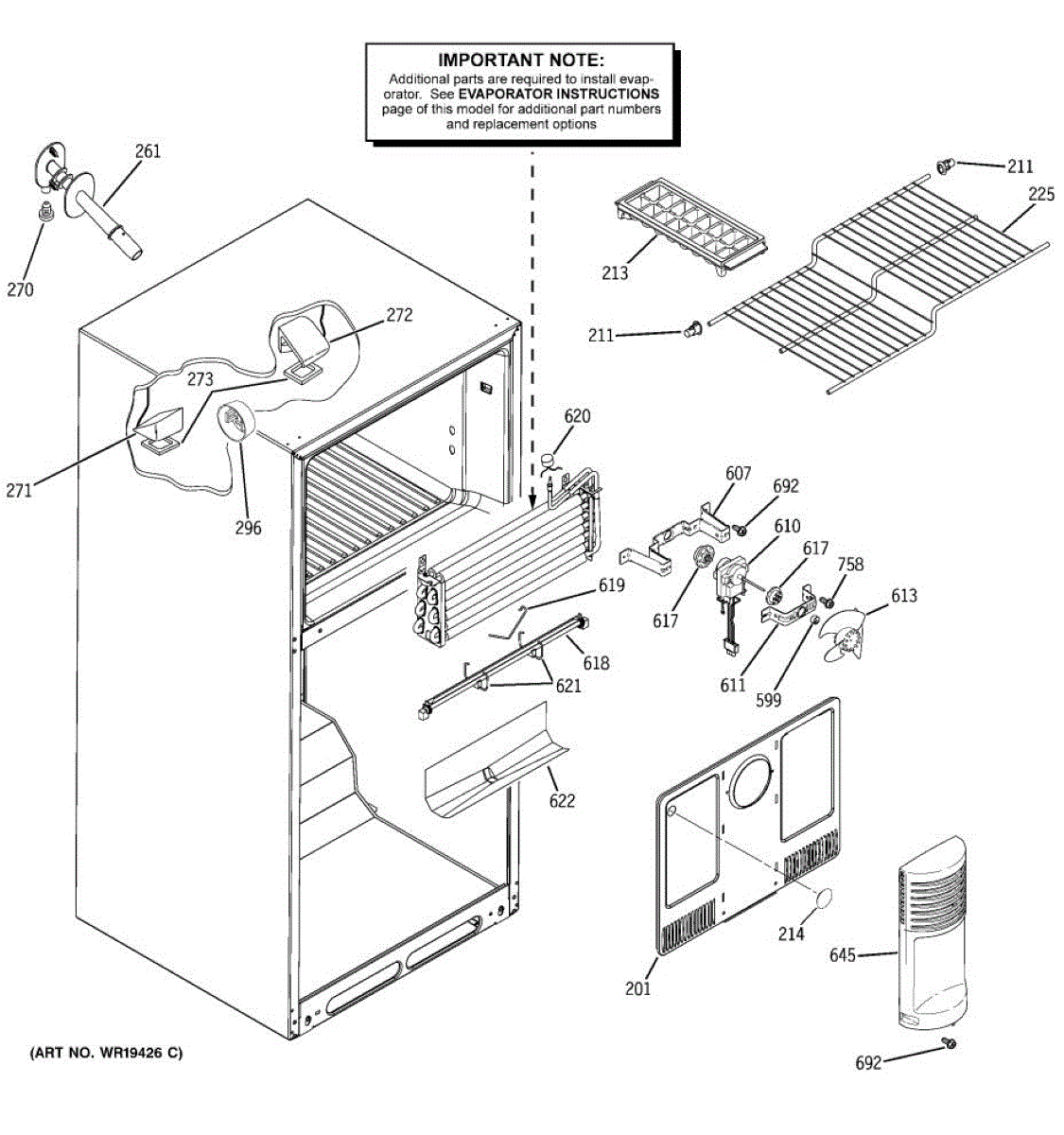

Refrigerator plug button that installs in the cabinet or liner. Replace this insert if the original is cracked, broken, missing, or worn from use.

Protective cover for the icemaker receptacle in your freezer compartment. Prevents moisture from entering the socket when an icemaker is not installed.

Secures and seals water line connections in your refrigerator's dispensing system. Replace if leaking or loose to prevent water damage. Confirm fit.

Refrigerator not cooling but freezer works? A failed evaporator fan motor stops cold air circulation. DIY-friendly repair with basic tools in 30-60 minutes.

Freezer fan loud or not spinning? This evaporator fan blade circulates cold air over the coils. DIY-friendly repair with our video guide.

Fix a warm fridge or freezer ice buildup. This defrost heater melts frost on evaporator coils to restore cooling. Moderate DIY repair, 1-2 hours.

This replacement defrost heater warms the freezer's evaporator area during the automatic defrost cycle. It melts accumulated frost so air can circulate, helping maintain stable temperatures and preventing ice buildup on the back wall.
  • Heats the evaporator to clear frost and ice during defrost
  • Helps keep airflow passages and the defrost drain path open
  • Common symptoms of a failed heater: heavy frost on the back panel/coils, poor cooling or warm sections, fan noise from ice contact, cooling returns temporarily after a manual defrost
  • Typically located behind the rear freezer panel
What's included: 1 defrost heater Install notes:
  • Disconnect power before servicing; wear cut-resistant gloves
  • Access the evaporator by removing the freezer's rear panel; thaw heavy ice before removal
  • Transfer any clips/brackets and route wires exactly as original, keeping them away from plastic parts
  • After installation, ensure wiring connections are secure and the heater is not contacting plastic surfaces

Fixes warm fridge with cold freezer caused by frosted evaporator coils. This defrost thermostat regulates defrost cycles. Moderate DIY repair, 1-2 hours.

This holder element assembly secures the appliance's heating element in the correct position so the element stays stable for consistent operation and safe performance. It's a direct-fit replacement for worn or damaged holders. What it does:
  • Secures and supports the heating element inside the appliance to maintain proper alignment
  • Prevents element sagging or contact with other components that can cause noise or arcing
  • Helps reduce vibration and movement that can lead to intermittent heating
  • Common symptom: visible holder damage, loose or shifted element, unusual noise during operation
What's included: One holder element assembly Install notes:

Drain trough that channels defrost water to the drain pan in your top-mount refrigerator. Replace if cracked, warped, or missing to prevent leaks.

Replaces a cracked or broken freezer tower bottom cover that mounts beneath the evaporator assembly. Directs airflow and protects internal components.

Replacement mounting screw for securing panels, trim, and internal brackets. Needed when original fasteners are missing, stripped, or damaged.
