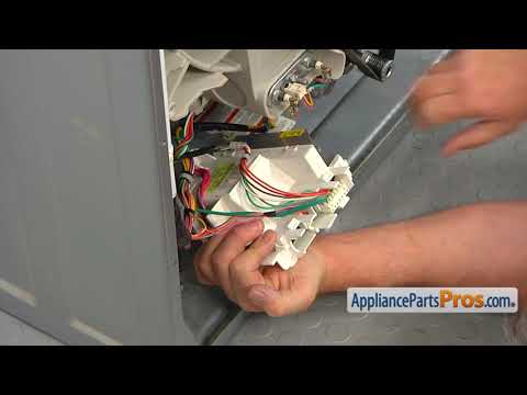

Susan R Beverly Hills , FL March 03, 2017 Appliance: Frigidaire Washer FAFW4011LW0 E53 error code After taking the top off the washer I found the Tech Data Sheet ( for repair person ) The E53 code was listed as Low Voltage to the motor board and referred me to test #15. Which stated to check the "drum water NTC" ( Negative Temperature Coefficient or Thermistor). What was misleading was that there are 2 NTC's. If your washer has a "Sanitize" feature , then there is a drum water NTC as well as one on the fill valve body. IF you have the sanitize feature then you need to replace the drum water NTC if it tests bad ( should be a reading of 4.8k ohms) if it tests good then replace the motor board. IF , like me, you do not have a sanitize feature, then you'll need to replace the motor board. Because AppliancePartsPros have such a great return policy, we purchased both the motor control board as well as the main control board just in case both had gone bad. We spoke to Ashley in the office and found her to be very knowledgeable and very helpful. No more laundromat ! Thank you AppliancePartsPros ! We will recommend you to everyone! Read More... 9 People found this story helpful Do-It-Yourself Rating: Repair Time Estimate: 15-30 minutes Tools: Pliers, Screwdrivers

Oliver C Covington , GA October 24, 2016 Appliance: Frigidaire Washer FAFS4474LA0 Machine run for a couple sec then shuts off or stop got e 53 error code Appliance parts pros recommended changing out the control board to correct the e-53 error code, got the control board in 1.2 days, took 45 mins to change out, machine running like new. Read More... 1 People found this story helpful Do-It-Yourself Rating: Repair Time Estimate: 30-60 minutes Tools: Pliers, Screwdrivers
Olga S San Jose , CA December 17, 2020 Appliance: Model 137279200 0908 Bad motor control board My husband replaced the board that we purchased from your store and it worked perfectly. We also purchased a drive belt but it's too short and would like to replace it with the correct one. Read More... 1 People found this story helpful Do-It-Yourself Rating: Repair Time Estimate: 15-30 minutes Tools: Screwdrivers
