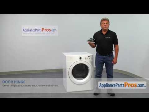

Jerry M Ravenna , OH September 23, 2018 Appliance: Model DON’T HAVE IT WITH ME Dryer door would not close properly Replaced the hinge and female latch Read More... 5 People found this story helpful Do-It-Yourself Rating: Repair Time Estimate: 15-30 minutes Tools: Screwdrivers
Denise H Birmingham , AL June 10, 2018 Broken dryer hinge. Replace dryer hinge. Read More... 1 People found this story helpful Do-It-Yourself Rating: Repair Time Estimate: 30-60 minutes Tools: Screwdrivers
Ruth V Loris , SC July 03, 2020 Our dryer door would not stay closed, discovered the hinge was bent Ordered a new hinge and door latch. Husband watched the installation video and completed the project in an hour start to finish. Read More... Do-It-Yourself Rating: Repair Time Estimate: 1-2 hours Tools: Screwdrivers
James M Rutherford , NJ September 07, 2020 Broken hinge Ordered part and fixed it myself. Read More... Do-It-Yourself Rating: Repair Time Estimate: 30-60 minutes Tools: Pliers, Screwdrivers
