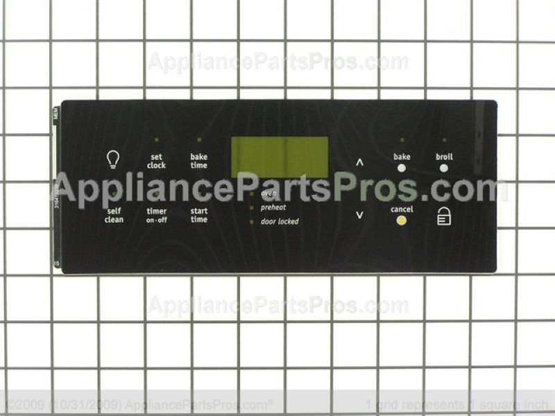

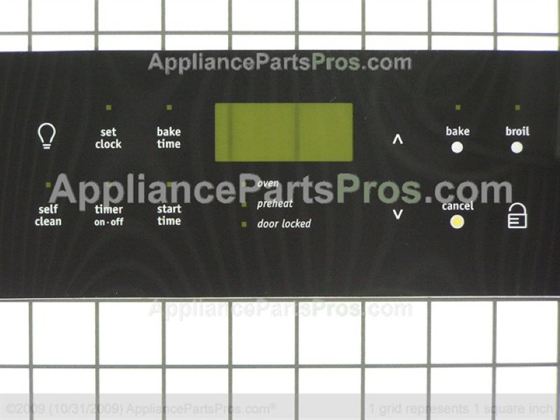

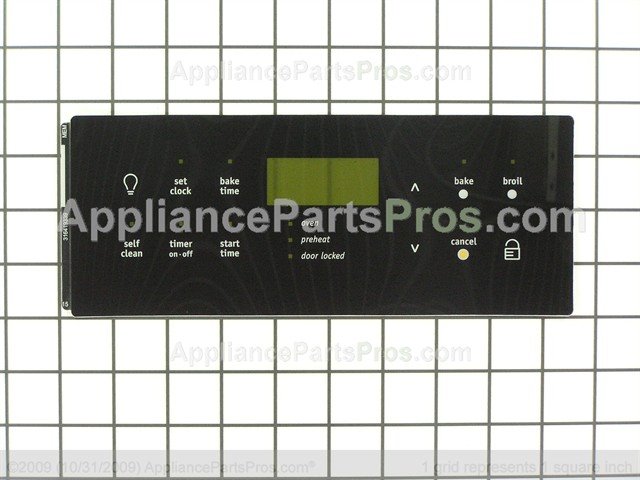

Billy J Belleville , IL March 19, 2016 Appliance: Frigidaire Gas Range LGGF3042KFC Oven stopped working Replaced control board and overlay, only took 15 minutes, oven works again and it saved me $900 which is what a new stove would have cost. Read More... 6 People found this story helpful Do-It-Yourself Rating: Repair Time Estimate: 15-30 minutes Tools: Nut Drivers, Screwdrivers
Chad C Texarkana , TX May 12, 2017 Clock timer was melted and broken at attachment points no longer functioned Ordered the new parts, removed the old timer and replaced it with the new one. I had to position the peel and stick over lay on the timer and attach the timer with 4 screws that I saved. The timer only plugs in one way so the swap out was very simple. The knob was a simple change out. Read More... 2 People found this story helpful Do-It-Yourself Rating: Repair Time Estimate: Less than 15 minutes Tools: Screwdrivers
Christopher J Round Mountain , NV April 20, 2020 Appliance: Frigidaire Electric Range LGEF3031KBB F10 The stove became real hot and smoke came from the back. The display read F10. We turned off the breaker. After reading up on the internet and in the manual I turned the oven on again. Sure enough, the broiler element turned on instead of the oven one. I turned off the power and took the back panel off. The burned up relay was super obvious. I double checked what I needed on AppliancePartsPros. Then I ordered and replaced the Clock/Timer (control unit Part No. AP4513486). Make sure to order the overlay for the unit too (Part No. AP4499672). Some people say you can salvage the old one but I wasn’t going through that process. Swapping the parts was quick and easy. Saved the stove. A relay on the old unit failed. Found it burned up. This caused the smoke and the oven broiler to heat up. Read More... 1 People found this story helpful Do-It-Yourself Rating: Repair Time Estimate: 30-60 minutes Tools: Nut Drivers, Screwdrivers
