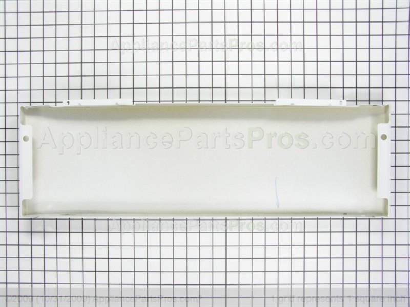

Kenneth J Belleview , FL March 17, 2015 Appliance: Model 417 44152400 Rusted front panel on kenmore front loader washing machine Lifted front of washer on 2x4 blocks to access the 2 screws. Removed to retaining screws then used blade of flat screwdriver to gently pry panel down. Removed the two plastic alignment widgets from the old panel and installed them on new. Removed with use of small adjustable wrench. Needed 1/4 turn to align them with square hold then removed. Installed plastic widgets into new panel. Installed panel back on to washing machine and installed 2 retaining screws. Done!! Read More... 8 People found this story helpful Do-It-Yourself Rating: Repair Time Estimate: Less than 15 minutes Tools: Adjustable Wrench, Screwdrivers
Earl A Slidell , LA April 20, 2015 Appliance: Model 417 44052401 Badly rusted bottom panel Installed a new paned. You must remove the two plastic locating knobs from the old panel and install them into the top of the new panel. They remove easily by grabbing them with pliers and twisting. I also used some small blocks of wood and a pry-bar to push up on the screw tabs of the new panel to get them to line up with the holes in the frame of the washer. Read More... 5 People found this story helpful Do-It-Yourself Rating: Repair Time Estimate: 15-30 minutes Tools: Pliers, Screwdrivers
