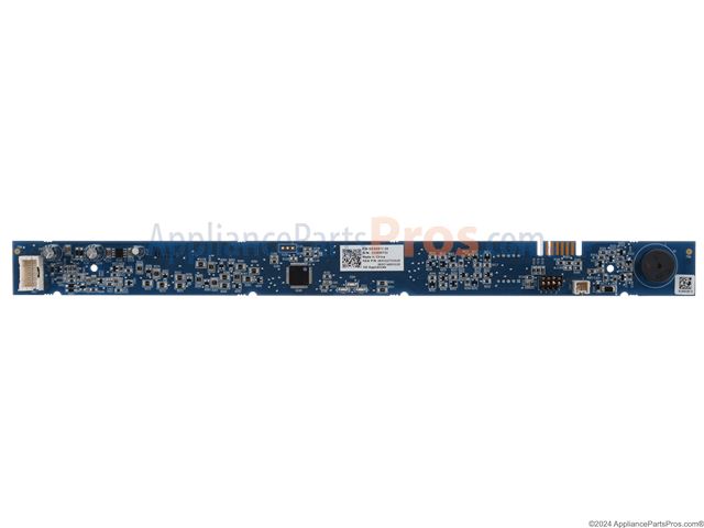

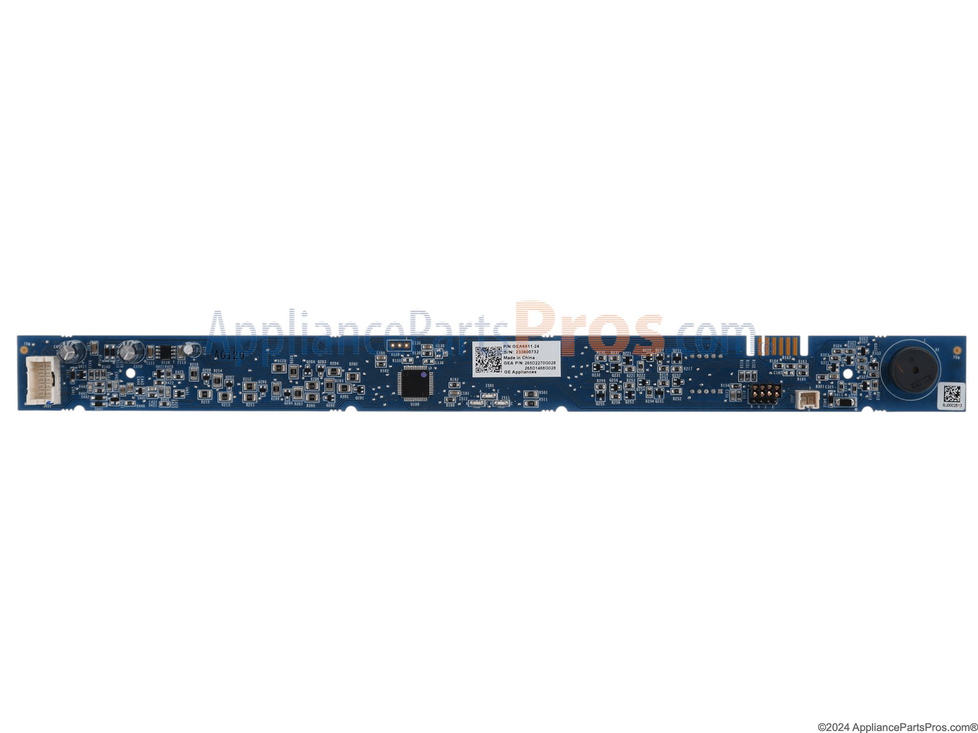

Christopher P Fletcher , NC July 17, 2021 Appliance: General Electric Dishwasher PDT825SSJ2SS No lights. GE Profile dishwasher almost 4 years old appeared dead. Checked circuit breaker (nope). Followed instructional video on RepairClinic.com for GE Dishwasher Main Control Board Replacement. Cut power. Removed the lower access panel and insulation. Unplugged the door wire connector, then reconnected and restored power to see if that's all it was (nope). Cut power. Removed junction box cover and unscrewed control board support panel. Lowered the support panel to visualize the board. Restored power to see if the control panel service LED was operational. Steady green LED on main control board indicated the problem was likely the UI circuit board at the top of the door. Cut power. Reattached the control board support panel and junction box. Followed instructional video on RepairClinic.com for GE Dishwasher Control and Display Board Replacement. The water line and power supply line were slack, so removed mounting bracket screws securing the top of the appliance to the cabinet and moved dishwasher several inches out. Unhooked both door cables from the hinges, disconnected door wire connector and somehow detached that cable from the retainer inside door (blind step). Lifted door from hinge supports and laid it on the rug. Removed the two lower hinge screws That's when I hit a snag, which caused some delay. The hinges didn't slide out as they do in the video. Moved on to the next step and removed the upper screws securing the inner door panel to the outer panel. But neither the hinges nor the inner panel budged. Eventually, I noticed screws on the sides of the inner panel, 2 on each side. Removing these screws allowed the inner panel to separate from the outer. Never did have to remove the hinges. Placed inner panel on the counter, disconnected UI wire connectors at the top. Removed the 4 mounting screws, the middle 2 of which are quite long. Pulled the UI mounting board out. Pried off the light bezel and replaced the old UI circuit board with a new one from Appliance Parts Pros (ordered Sunday, shipped Monday, arrived Tuesday). Still following the video, reversed many of the previous steps and restored power to test before sliding the dishwasher back under the cabinet. Lights! If you're patient and follow the video instructions, this can save you a ton of money. Couple a things: Blindly trying to reattach the door wire connector cable to its retainer caused several cuts on my index finger. Obviously a razor-sharp edge in there somewhere. I'm not sure If I ever correctly reattached it. Also, take care to study how the insulation sheet was installed because you'll have to recreate it when you put it back. Note how it folds and what it covers and how the cutouts on the ends make room for the lower access panel screws. Take the opportunity to level the feet and position the dishwasher squarely in its cabinet. A most satisfying little project (because it worked). I am definitely more manly now than I was before. Read More... Do-It-Yourself Rating: Repair Time Estimate: 1-2 hours Tools: Nut Drivers, Screwdrivers
Frank D Newark , CA June 15, 2021 Appliance: General Electric Dishwasher PDT825SSJ2SS Blacked out ui panel won't turn on Originally tried replacing the main control board (steady green LED) on my PDT825SSJ2SS and didn't solve. Main symptom was dishwasher kept turning on and off on it's own every few minutes until the DW finally died and became unresponsive. Built back in 2017 -- replaced UI top logic after pulling the door off along with door harness and all is well again. One caveat for separating the two pieces of the door on the PDT825SSJ2SS model, there are 6 of 8 screws that you need to remove. Instead of pulling outwards as seen videos online, you need to push/slide the inside panel forward (away from you) first and then pull up as there are clips that hook into the outside door frame. If you pull outwards (or up) without sliding first, you will break the clips that attach the inside panel to the outside door frame. Read More... 18 People found this story helpful Do-It-Yourself Rating: Repair Time Estimate: 1-2 hours Tools: Nut Drivers, Screwdrivers, Socket Set
Mark W Monroe , CT January 28, 2022 Appliance: General Electric Dishwasher PDT825SSJ0SS Ge dishwasher would not turn on / respond at first cycling the power would sometimes fix the issue but it gradually got to the point where we could not get it on First I tried replacing the control board on the bottom of the unit. But that did not fix the issue. I also noticed that the LED power indicator on the control board was lighting up fine... so that should probably have tipped me off initially that the control board was not the issue. After a little more research, I decided to try the user interface board at the top of the machine. This board was a bit more of a pain to access, but machine started right up and has been working well since replacement. Read More... 5 People found this story helpful Do-It-Yourself Rating: Repair Time Estimate: 30-60 minutes Tools: Adjustable Wrench, Screwdrivers, Socket Set
Jeff R Lake Elmo , MN April 25, 2021 Appliance: General Electric Dishwasher PDT825SSJ0SS GE dishwasher control panel was blacked out I replaced the UI board and fixed the problem. Read More... 4 People found this story helpful Do-It-Yourself Rating: Repair Time Estimate: Less than 15 minutes Tools: Adjustable Wrench, Pliers, Screwdrivers, Socket Set
Patrick D Burke , VA October 01, 2022 Appliance: General Electric Dishwasher PDT825SSJ0SS No response or lights on the buttons of my 2017 GE Profile dishwasher. No communication to the controls from the main board. We purchased a new UI Board to be replaced in the door of the dishwasher. Looked at YouTube descriptions of the removal of the door and taking apart the door for access to the UI Board. Did the work and replaced the board. The dishwasher works fine now, Read More... 3 People found this story helpful Do-It-Yourself Rating: Repair Time Estimate: 1-2 hours Tools: Nut Drivers, Pliers, Screwdrivers
