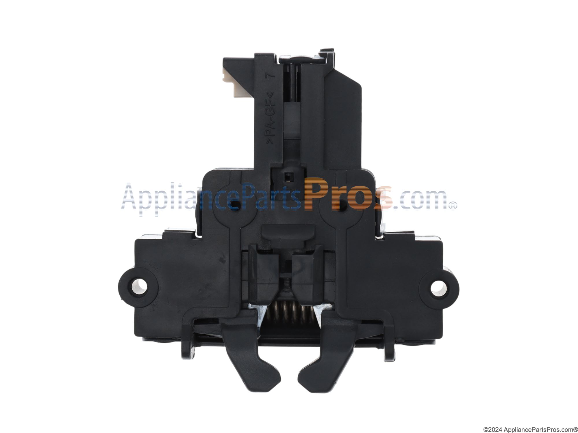

Christian Z Saginaw , MI February 02, 2021 Dishwasher powered up but did not run. Based on our research, the dishwasher latch was one of the most common causes for our model of dishwasher malfunctioning. We purchased this replacement unit, and thanks to the help provided via videos and diagrams, my wife and I were able to very easily install the new latch. While this replacement did not totally fix our problem, it was part of it. Shipping on the part was very quick, I ordered it on Friday night, and the latch arrived Saturday morning. Read More... 11 People found this story helpful Do-It-Yourself Rating: Repair Time Estimate: 15-30 minutes Tools: Pliers, Screwdrivers
