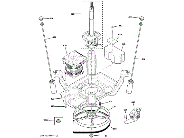

Tim F Wichita , KS April 07, 2018 Appliance: General Electric Washer GTWN4950L0WS GE Hydrowave washer would not fill. Fill light just blinked and it beeped every 20 seconds or so. I originally thought the problem was the control board, so I replaced it first (hey, it's cheaper). Didn't work. The control board had indicated it was communicating (voltages were present). The motor was displaying a 10-blink communication error code occasionally but not consistently. Replacing the motor fixed the no-fill problem. The washer was in pretty good shape so I decided to go ahead and rework it for my daughter. I replaced wear items (including the mode shifter) and cleaned it up. Had the tub in and out of the cabinet several times and got pretty good at doing it. It's a simple machine and once you know the tricks it only takes five minutes to get the tub out. The drive belt is a very tight fit, I could not install it with the tub in the cabinet. I didn't buy the installer tool but it's not bad to put on with the tub out and upside down. The hardest part was removing the tub nut. This was not required to fix the no-fill problem but I wanted to clean the tubs out. I bought a $10 spanner tool and beat it up pretty badly with a sledge without budging the nut (it's a reverse thread, be careful of that). Tried heating it too, also without luck. Ended up having to cut it off with a small oscillating tool; it was corroded to the shaft. The nut is soft metal so it's not a bad job to do. Once that was done the rest came apart easily. Tools: Thin putty knife to remove the front cover 1/4" and 5/16" nutdrivers Needle-nosed pliers to undo electrical clips and remove the lid switch 7/16" socket to remove the pulsator bolt under the agitator Other sockets to remove the mode shifter shaft (don't remember size) 3/8" box wrench to change out the motor Adjustable pliers to remove the clamp ring from the drain hose from the drain motor The project time I indicated below is just for replacing the control board and motor (30-60 minutes). I was already familiar with how it came apart from cleaning it up previously. Read More... Do-It-Yourself Rating: Repair Time Estimate: 15-30 minutes Tools: Adjustable Wrench, Nut Drivers, Pliers, Socket Set
Richard R Littleton , CO October 19, 2019 Appliance: Model GTWN4950LOWS GE washer noisy stopped spinning 4 flashes on motor code GTWN4950lows - sounded like a tornado during the spin. Eventually broke and stopped spinning. 4 flash code from the motor, so replaced the mode shifter/shaft. Read elsewhere that if you get 4 flashes, test the mode shifter for continuity with a tester, I got an about 70-ohm reading which means it's not the mode shifter but the motor. This turned out to be correct because after replacing the mode shifter (difficult time-consuming job) it still didn't spin, but replacing the motor (easy job) fixed problem. Not sure if motor alone would have fixed the noisy spin problem, but I replaced everything while I was in there - bearing, belt, split ring, tub seal. Now runs very quiet as it should. That said, HUB NUT would not come off, BEARING would not come out both super tight. After pounding the crap out of the hub nut with spanner wrench (wrench also had some play, had to use some washers to snug up and not round off edges of hub nut) for more than an hour, had a neighbor come over to hold the tub from spinning. Then the whole shaft assembly underneath started turning so neighbor held wheel underneath. Finally broke loose (after a lot of WD40 too). No way BEARING was coming out with screwdrivers like in the video. Tried that for over an hour. Had to pound out from the other side. You could use a big socket to pound (would have to be at least 25 or 26mm) I ended up using an old bicycle bottom bracket! Have to take off the hose, and put the tub on 4x4s or a couple of 2x4s, and then use a 2x4 to pound because you can't swing a hammer in there. It took about half an hour but eventually came out. Also, there is one TORX screw on the bottom. I got it out with a small flathead. On this model with a SMALL AGITATOR, it doesn't snap out like the bigger agitator. There is a screw holding it in. Take fabric softener dispenser out by turning it to the left to get to screw. Tub seal was chewed up and probably leaked. Replaced that. Use lots of soap-like in the video on both seal AND tub to get in there snug. The belt tool was helpful. The belt that came off was part P003/5 rib. The replacement belt was part P001/6 rib. Works great. Cleaned everything while in there too. All in all, this was a time-consuming job and cost close to $400. Basically it is a new washer now. I estimate a new washer to be close to $600 with tax and old washer haul away. Hope this helps! Appliance parts pros are awesome... best prices, quick delivery (2 days) and great repair videos. Got two $100 wine vouchers with my parts - nice! Even spoke with a technician. Read More... Do-It-Yourself Rating: Repair Time Estimate: 2+ hours Tools: Nut Drivers, Pliers, Screwdrivers, Socket Set, Wrench Set
Barry R Hummelstown , PA August 22, 2016 Appliance: General Electric Washer GTWN4250M0WS Flashing fill light with beep flashing 10 on motor card It's always a tough decision on how much time and money to spend on an older $500 appliance. Besides fixing things being in my nature, Appliance Parts policy of allowing returns for any reason made the decision a lot easier. My 2+hour project time was due to lots of research and analyses trying to pin-point the exact cause. It still came down to a toss up between the control card and the motor. The control card did not fix, the motor did. Part replacement was in the 15 - 30 minute range. A little bit of hang up with the motor installation as the instructions that actually came with the washer did not match the configuration of the motor mounts. Also problem on how to reinstall the belt but a Youtube video simplified that using a wire tie even though I didn't have the recommended tool. As motors are pretty reliable, I suspect it is the card and it's too bad you can't just order and replace the card making it a much cheaper fix. Read More... 8 People found this story helpful Do-It-Yourself Rating: Repair Time Estimate: 2+ hours Tools: Nut Drivers, Socket Set
Brad E Franklinton , NC July 24, 2015 Appliance: General Electric Washer PTWN6050M0WT Motor/inverter board assembly I unplugged all the plugs from the old motor assembly. Removed the belt from the pulley and unbolted the motor assembly. Installed the new assembly and plugged it in. Installed the belt and plugged up the various wiring. Plugged in the machine and presto, working great again. The only thing was a kit that comes in the package to fix a wiring problem with older models but I didn't need to use it, so takes a few moments to verify if your unit needs the kit or not. I could have bought the part a little cheaper from ebay or even used but no one offered the type of warranty that AppliancePartsPROS.com does. Awesome company. Read More... 3 People found this story helpful Do-It-Yourself Rating: Repair Time Estimate: 15-30 minutes Tools: Screwdrivers, Wrench Set
