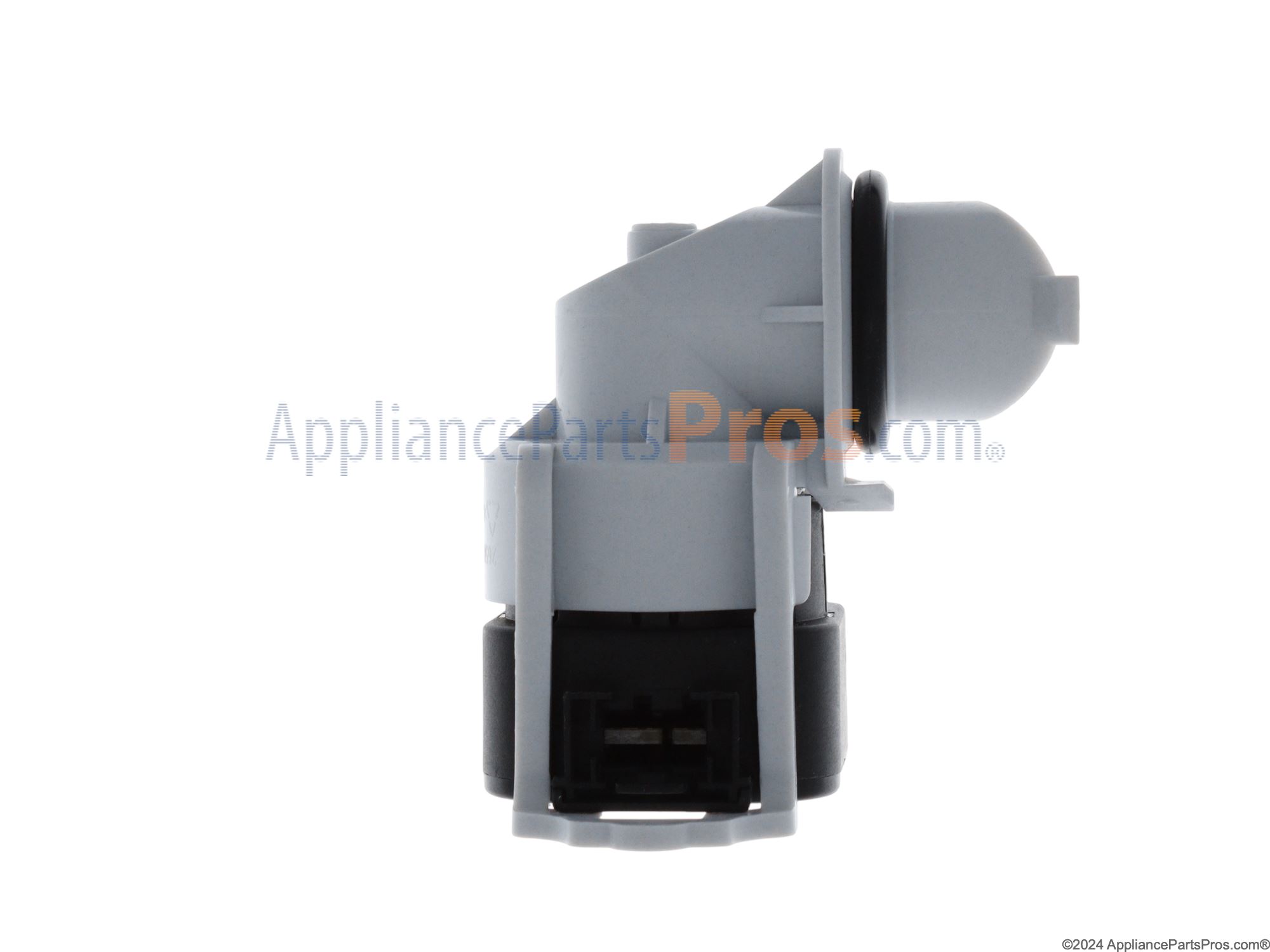

Joe D Lockport , NY August 07, 2025 H2o error code Tried to fix with a non GE part, didn’t work. Your GE brand pressure sensor worked like a charm Read More... 2 People found this story helpful Do-It-Yourself Rating: Repair Time Estimate: Less than 15 minutes

Robert R Goldsboro , NC November 15, 2025 Appliance: General Electric Dishwasher PDP715SYV0FS Ge profile dishwasher had h20 error code It was one of 3 things basically, motherboard, pressure sensor or fill valve. I tried cleaning the pressure sensor to no avail. I proceeded to replace both the valve and the sensor because the parts were very inexpensive and the cost of a motherboard wasn't worth it. I completed the repair in about 1 hour and have ran it twice without incident . Read More... 1 People found this story helpful Do-It-Yourself Rating: Repair Time Estimate: 30-60 minutes Tools: Nut Drivers, Screwdrivers, Socket Set

Scott B Chelmsford , MA June 22, 2026 Appliance: General Electric Dishwasher PDT715SMN0ES Dishwasher would stop at the beginning of the cycle while trying to drain any existing water before starting to add water for the cycle I had previously removed and cleaned the drain pump and water flow/level sensor. It seems that was a one trick pony. I was able to easily identify and order the parts related to this part of the dishwasher cycle from the site. They arrived when expected, fit perfectly and the dishwasher works again. I also took the time to remove and clean the drain hose and the port on the disposal that it connects to. I also cleaned the inside of the tub and the upper rack rails. The drain pump arrived with the small tab that secures the electrical connection broken off and moving freely inside its box. This did not impact the usability of the part but it might be helpful to wrap the pump in small bubble wrap or similar. Read More... 1 People found this story helpful Do-It-Yourself Rating: Repair Time Estimate: 1-2 hours Tools: Nut Drivers, Screwdrivers, Wrench Set
