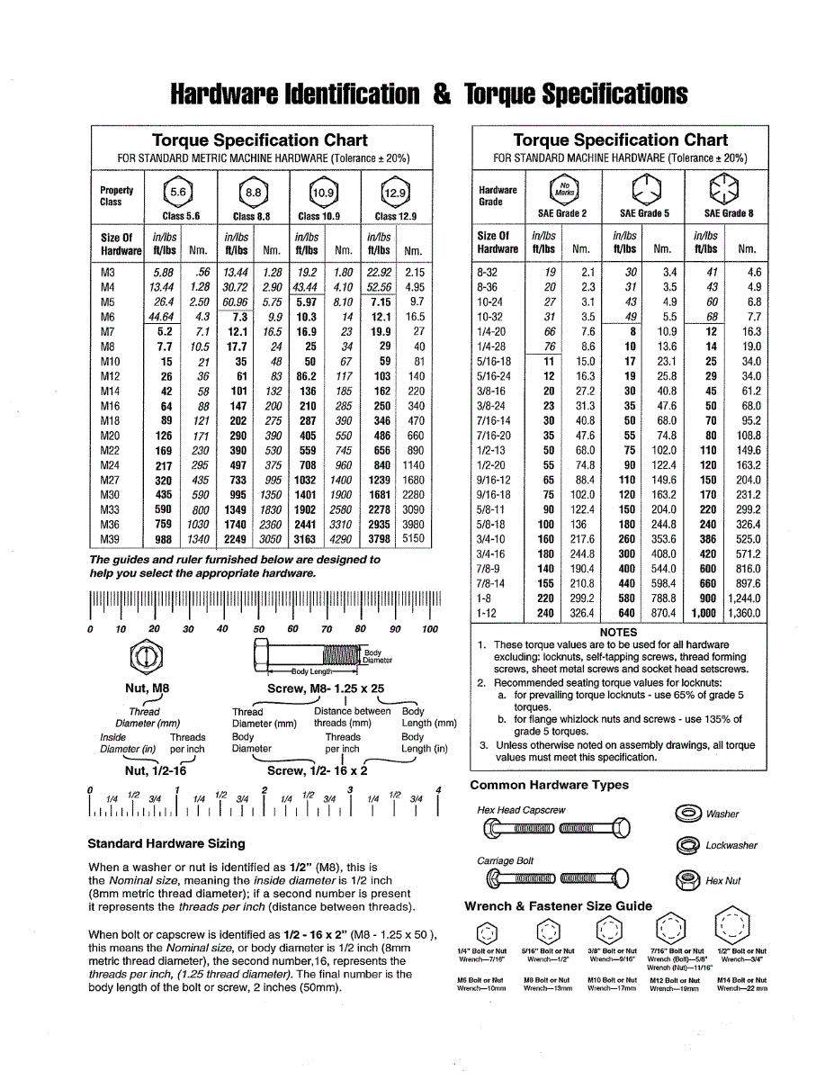

Parts for Craftsman 580752450: Hardware Id & Torque Specs Parts
