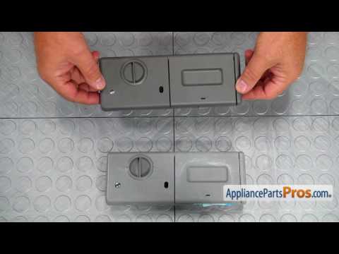

Jay C Phila , PA August 15, 2014 Soap dish would not stay closed Easy to fix. First shut off electric at fuse box. Remove front panel with screws just inside the door edge. Then remove the dispenser brackets screws and brackets. Carefully remove the 3 wire connections. Now pop out the old dispenser. Install the new dispenser, wires, brackets and door panel in reverse order. Read More... 8 People found this story helpful Do-It-Yourself Rating: Repair Time Estimate: 15-30 minutes Tools: Screwdrivers
Charles C Hillsboro , OH February 03, 2015 Appliance: LG Dishwasher LDF7932ST Soap dispenser cover would not stay closed What an easy fix! Ordered new soap dispenser from AppliancePartsPros and received it within 24 hours. Unplugged the dishwasher from the wall socket(if yours is wired direct you'll have to trip the breaker). Removed 12 screws from around inside of the door(you don't have to remove the 2 closest to the latch) and dropped the outside side skin off. Removed the 3 electrical plugs(mark where the 2 on the left go so you don't get 'em backwards putting it back together. Removed the 6 screws and brackets holding the dispenser in the door. Now it gets just a bit tricky, I used 4 plastic putty knife style spreaders to hold the metal catches up off the tabs and pushed the dispenser out. You could probably use screwdrivers or regular putty knives, etc, I just happened to have those plastic spreaders like are used to smooth body putty on metal. Once you get the old one out you're pretty much home free. Just pop the new dispenser in, replace the brackets and screws, plug in the three electrical plugs(don't forget how the 2 on the left go), Put the skin back on the door, and plug her in(reset breaker), you're all ready to wash dishes again. And, the whole experience only takes about 20 minutes assuming the 3 year old doesn't carry off a couple screws and the dog doesn't chew the electrical plugs. I estimate I saved around $120.00 doing this myself. Read More... 4 People found this story helpful Do-It-Yourself Rating: Repair Time Estimate: 15-30 minutes Tools: Screwdrivers
Bruce R Boulder , CO April 04, 2015 Broken detergent dispenser Following the helpful online video showing how to replace the dispenser, the repair was straight-forward. Read More... 3 People found this story helpful Do-It-Yourself Rating: Repair Time Estimate: 15-30 minutes Tools: Screwdrivers
Danielle T Lexington , KY September 30, 2014 Soap dispenser did not close Easy, with two unexperienced people, thanks to comments from another customer. Unscrewed face of dishwasher to expose back side of dispenser, unhooked electrical connections, used a flathead screwdriver to remove old dispenser, replaced with new, rebooked connections, screws, etc. Read More... 1 People found this story helpful Do-It-Yourself Rating: Repair Time Estimate: 15-30 minutes Tools: Screwdrivers
Phil M Darien , IL October 13, 2014 I had an lg dishwasher which had a broken detergent dispenser Easily found the matching part on your website. Ordered the part which was delivered FedEx in 2 days. Removed 12 screws from the door. Replaced part which fit perfectly and was back in business. Read More... 1 People found this story helpful Do-It-Yourself Rating: Repair Time Estimate: 15-30 minutes Tools: Screwdrivers
