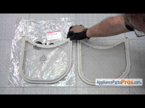

Pat G Walker , LA April 01, 2014 Lint getting past the filter We had a problem of lint building up inside of the filter slot. Once I took a long brush and cleaned the recess where the filter slides I was able to see that the old filter was not catching all the lint. Upon closer examination I noticed that the seal around the filter had become compressed. that's when I order another filter from AppliancePartsPros.com. My new filter came within three days and my dryer has been working fine ever since then. Read More... 93 People found this story helpful Do-It-Yourself Rating: Repair Time Estimate: 15-30 minutes Tools: Screwdrivers

Stephen R Peterstown , WV August 03, 2014 Appliance: Kenmore Dryer 79680311900 No error code just worn lint filter felt I turned off the electric at the electric panel for the dryer. Then I took apart the inside area were the lint filter was held and vacuumed it out with a small wet and dray vac. This collected all excess lint that had passed the worn filter that was being replaced. Then checked for any problems any where else, I saw none so I replaced all four screws and then fitted the new replacement filter. The new filter fit perfectly. The new replacement filter came quickly after I ordered it, the price was as expected, and the product was the correct one for my machine. Thank you Appliance Parts Pros. Finally my wife tested it and said things worked perfectly for her and that is the real test for me. Again Thanks! Read More... 10 People found this story helpful Do-It-Yourself Rating: Repair Time Estimate: 15-30 minutes Tools: Screwdrivers
