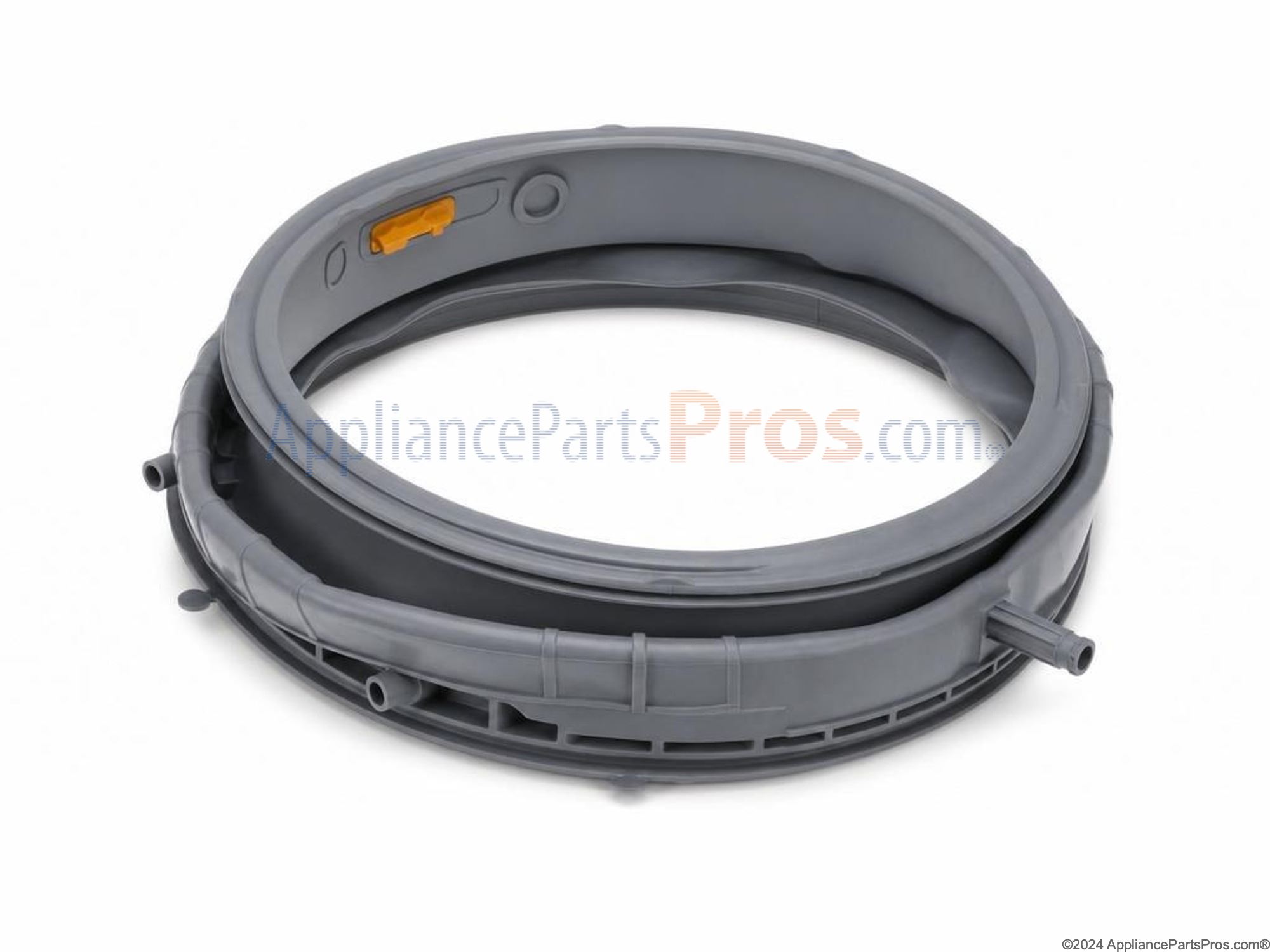

Roger R Monument , CO August 29, 2026 Appliance: LG Washer WM3900HWA A lg frontloader which needed a new door seal My LG WM3900HWA clothes washer needed a new door seal. In the past I replaced a door seal on a different manufacturer’s model so I did some web searching. I could not find a video specifically for my LG model number but decided to attempt to replace it myself after watching videos for similar LG models. As many warned, the LG was more difficult than average. However, if you are mechanically inclined and patient, it is reasonably possible. My suggestions are as follows. Buy a spring spreader. I called LG support and they actually suggested an inexpensive model which I purchased on Amazon. Remounting the spring cable clamps was the most challenging part so have someone available to help. I highly suggest you remove the front panel to provide access to the gasket; some videos suggest you can replace the gasket without removing the front panel. I am dubious about this claim. While very similar, my model was a bit more involved than the model used in the video. Sparingly lubricate the gasket mounting surfaces and spring cables with diswashing soap to aid in assembly. It took me 3 hours including time to clean all mounting surfaces after removing the old gasket and prior to installing the new gasket. Read More... Do-It-Yourself Rating: Repair Time Estimate: 2+ hours Tools: Nut Drivers, Pliers, Screwdrivers
John R Plainfield , IL August 09, 2023 Appliance: Model WM4000HWA/01 Mold on washer door gasket. Replaced gasket. This is the correct part number for LG washer WM4000HWA/01. The first part sent out was incorrect, but Michaela researched it further and found the correct part, and exchanged the other one that was sent. This part is somewhat more difficult to install than most door gaskets due to hoses that connect to the side of it, limiting direct access to parts of the gasket while attaching it to the washer drum. Definitely needed the special spring installation tool for this job. Read More... Do-It-Yourself Rating: Repair Time Estimate: 1-2 hours Tools: Nut Drivers, Pliers, Screwdrivers
