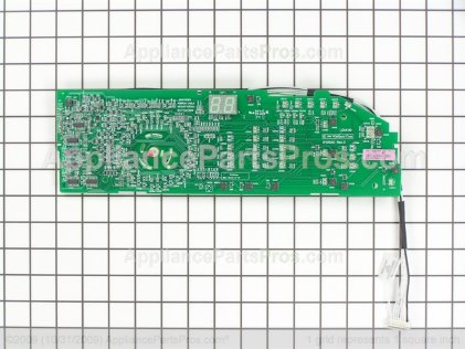

Paul October 15, 2012 for Model Number Centrl_Elec Hello. I only need the metallic sensor that fits inside the Encoder. That particular part was damaged, and I would like to avoid buying the whole new Circuit Board. Can you help? Thank you.
1 Answer Hello Paul! Unfortunately, the manufacturer does not supply the parts on the electronic control board WP8564288 separate from the board assembly. Sorry about that! Read More...
David H October 03, 2012 for Model Number WTW7340XW0 Is there any type of detail instructions available on removal and installation of AP4514631 circuit board? Thanks
David H October 03, 2012 for Model Number wtw73400xw0 I have a Cabrio top load washer, sometimes I have to push the satrt button 7 or 8 times to get the washer to start. There has never been any type of error code shown on the display. Would I have to replace the board to fix the problem?
1 Answer Hello David. Based on the information you provided, if the start button is not working, you will need to replace the user interface WPW10297397 in the unit. Read More...
