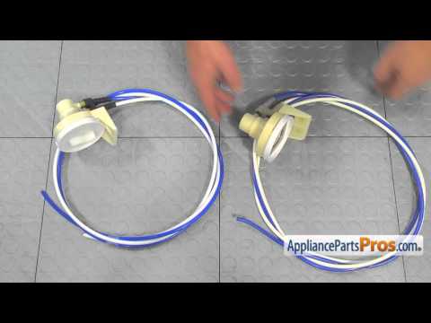

Gyanendra C Sugar Land , TX June 07, 2014 Leaking water filter Researched ApliancePartsPros.com to get an idea of how to correct the problem and then contacted Meredith over the chat. She went through diagnostic steps and then finally recommended changing the filter housing. Parts arrived in 3 days and I put it in the refrigerator last night. No more issues. Thanks. Read More... 9 People found this story helpful Do-It-Yourself Rating: Repair Time Estimate: 30-60 minutes Tools: Nut Drivers, Pliers, Screwdrivers
William U South Riding , VA November 13, 2015 Appliance: Samsung Refrigerator RS2533SW/XAA Cracked water filter housing Ordered the part, two screws, two nuts, install new part. It was a snap and took about 5 minutes and saved me 150 off of a service trip for diagnostics (different issue). Should have done it years ago. Read More... 4 People found this story helpful Do-It-Yourself Rating: Repair Time Estimate: Less than 15 minutes Tools: Screwdrivers, Wrench Set
Gordon H Charlotte , NC January 29, 2016 Appliance: Samsung Refrigerator RS2533SW/XAA Filter housing was cracked Part that came was not exact match (no hooks on back) but worked fine. The blue water line was shorter than original and just barely reached. The job was quite easy. The only part that required a little research was understanding how the fittings on the ends of the water lines were removed and re-attached. Mine were simple compression fittings that just pulled off and pressed on (slid onto nipple attachment points). No cutting required. There are a few other types out there though. While I had the lower back panel off of the fridge (to attach blue line) I vacuumed the coils. They had ten years (my bad) worth of dust on them. Read More... 3 People found this story helpful Do-It-Yourself Rating: Repair Time Estimate: 30-60 minutes Tools: Screwdrivers, Wrench Set
Todd B Palmyra , PA April 18, 2017 Appliance: Samsung Refrigerator RF26VABBP/XAA-0000 Water leaking at filter housing After trying a new filter, and water still leaking, purchased a new housing. Very simple fix. Took about 10 minutes. Works perfect now! Samsung Rf26vab Read More... Do-It-Yourself Rating: Repair Time Estimate: Less than 15 minutes Tools: Adjustable Wrench, Screwdrivers
