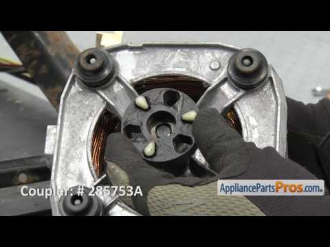

Ismail N Chappaqua , NY January 29, 2020 Appliance: Model KENMORE 11022942100 Wet laundry after spin cycle (Kenmore 11022942100; 18 years old) Replaced clutch, clutch (AP6012576 ), retaining clip ( AP6014902) , washer motor coupling (AP3963893 ) and cam agitator assembly. (AP4379828 ). Would have replaced the brake cam driver since it was accessible during the job but this part was not included in the AP6012576 kit, nor suggested by the web-page. The new cam agitator assembly comes w/ a 7/16"hex bolt, while my machine had a double-ended stud w/ a 9/16" head in the middle. The old retainer threads into the top stud and needs a 1/2" square drive bar to remove. I re-used the old retainer. Straightforward job for mechanically inclined. Took four hours which included set-up, disassembly, reassembly, test, and clean up. Make sure that you drain the water in the washer before disassembling anything. I used a deep roller tray and laid the machine unto its back, supported at the frame sides with four 4x4 blocks. Expect 1/2 gallons of water or thereabouts. Keep lots of rags handy. Hope the old girl will keep going as long as we do. Read More... Do-It-Yourself Rating: Repair Time Estimate: 2+ hours Tools: Nut Drivers, Pliers, Screwdrivers, Socket Set, Wrench Set
