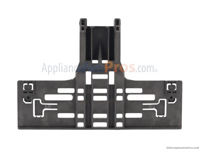

Gary G San Francisco , CA April 27, 2019 Upper rack adjuster cracked I bumped into my KitchenAid dishwasher and the upper rack adjuster cracked. There was already a crack on the notch of the housing where the handle (lever) sits. In addition, the positioner popped out and I couldn't find it. So, I bought the three parts from AppliancePartsPros online. It arrived in about a week. The repair was fairly simple, but it still took about 45 minutes because I didn't want to crack the assemblies. For the housing, use a small slotted screwdriver to carefully remove the cover from the housing (you do not have to remove the lever). The Positioner was a little tough to remove from the rack. It as a little tight and you have to tilt it a little to angle it out. The rack adjuster was also tough to put in. Taking the old one out seemed easy. There are actually two positioners. The other one is elongated. That one was also tough to take out and put in because you also have to angle it in. And, you must remove the small positioner before you remove the elongated positioner (reverse order when installing). The rack adjuster itself was the toughest to put in. There are two notches near the bottom which fits into the rail. Angle in the inner notch first. Then snap in the outer one. It is a tight ft. Go slowly so you don't break the plastic. Once the bottom notches are in place, you put in the positioners. You might be tempted to remove both adjuster and totally remove the rack first. But it would take twice the effort to put the adjusters back. I just worked on the broken side, being careful not to drop the rack. Also, it helps to the have the other (good side) visible as a sample when installing the broken side. When ordering, make sure the housing lever is pointing the correct direction. After installation, the rack is now rolling steady and can be adjusted up or down. When adjusted down, make sure the tallest dish at the bottom does not hit the rack sprayer. It can actually touch the sprayer a slight little and the dishwasher would still work correctly. Good luck on your repair. The KitchenAid dishwasher I have is extremely quiet and works beautifully. Read More... 49 People found this story helpful Do-It-Yourself Rating: Repair Time Estimate: 30-60 minutes Tools: Screwdrivers
Lawrence C Austin , TX October 22, 2019 Appliance: Maytag Undercounter Dishwasher MDB8959SBS1 Upper rack adjuster will not stay attached to the sliding track. (Tip 1: If you need to replace BOTH adjusters, work on only one side first so that the other side can be used as a reference.) (Tip 2: Take a photo with your cell phone of the assembly before beginning the remove and replace process.) Remove the empty upper dish rack by sliding the rack all the way out and then carefully lifting the front end of the rack (the end nearest you) until it disengages from the sliding metal tracks on both sides of the washer and then pulling the rack carefully toward you to disengage the rear attachment from the sliding track. Place the rack on a flat surface with the malfunctioning adjuster facing you. Using a small flat end screw driver, remove the cover from the lever housing by gently popping the two lower ends of the cover from housing and then rotating the cover upwards. The entire housing should now come off the rack. (Note what the upper end of the adjuster looks like so that the replacement is not installed backwards.) On the lower right (assuming you are working on the right side of the rack) remove the long sliding attachment that holds the adjuster to the rack by popping the attachment from the rack and then sliding the attachment off of the adjuster. If you wish, mark the location of where the attachment clips on to the rack. This will serve as your "ground zero" for replacing everything. Move to the lower left of the mechanism and remove the other "slider" from the adjuster. To release the slider from the little "knob" on the adjuster, gently push the tab on the slider to release it over the knob. Once free from the adjuster, the slider can be removed from the rack by rotating it slightly so that it disengages from the frame work of the rack. I marked the location of this slider on the rack. Remember which end is up and which side is out. (See Tip #2?) The last connection .holding the adjuster to the rack is a "clip" located at the base of adjuster's extension that inserts into the lever housing. This clip easily "pops off" and is very inconspicuous. (In fact, one of mine was missing and I found it laying in the bottom of the washer.) Before removing the broken adjuster, remember which side is out. If the adjuster has fallen off the rack, look at the other adjuster to make sure you place the new one on correctly. (You DID remember to leave the other side installed so that you could use it as a reference didn't you???) To re-install, do everything in reverse (except for the small "clip". Install this after everything else is installed, assembled and working properly.) 1. Install the lower left "slider" by holding it against the rack frame and twisting it into position. Do not force it: It goes on easily if positioned properly. Hopefully you marked the location and/or took a photo. 2. Attach the main adjuster piece to this slider. Start by inserting the "knob" on the adjuster into the slot on the slider and then moving the adjuster until the slider "locks" into place. This is an easy piece to install backwards, so don't try to force anything. Check your positioning if you have an issue. 3. Attach the "long slider" to the adjuster. First, be sure the slider is facing properly (so that it will snap onto the rack frame.) Start by sliding it over the "bump" on the adjuster. Attach the slider to the frame of the rack. (Remember, you marked this spot.) 4. The Adjuster should now move freely and easily on the two sliders. If not, STOP and check for the problem. Check photos if necessary. 5. Position the lever housing and slide the adjuster into the housing and check that the lever works properly and that the adjuster moves freely inside the housing. If all works well, snap the housing cover into place. 6. Lastly, attach the clip that holds the adjuster to the rack. (The one just below the lever housing.) 7. If necessary, remove and replace the mechanism on the other side. Remember, the lefts and rights mentioned above will be reversed. 8. Reinstall the rack in the washer. Remember the front attachments to the tracks go in first and then the rear attachments drop into the tracks last. I hope this helps. It took me about 45 minutes to replace both adjusters. Read More... Do-It-Yourself Rating: Repair Time Estimate: 30-60 minutes Tools: Screwdrivers
