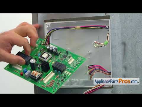

Forest W Traverse City , MI November 12, 2022 Appliance: Maytag Refrigerator MFI2269VEA10 The refrigerator stopped cooling and front panel was blank. The water and ice wouldn't dispense. The interior lights still worked A relay in my refrigerator would periodically click off, causing the compressor motor to stop and the LEDs on the front panel to turn off. This became more frequent until it finally "blanked out" permanently. No cooling, no lights on the front panel, no water or ice, only the inside lights worked. Isolating the problem to the control board was easy, and replacing the control board was very easy thanks to the videos and previous customer reports available here. After installing the board, I the LEDs on the front panel showed "PE0 000" and I couldn't get the refrigerator to cool. After some research online, I found a video that showed how to program the control board to match my specific refrigerator model. The steps are summarized below: 1. To enter programming mode, press and hold 'temp alarm'. 2. While holding 'temp alarm', press and hold 'freezer temp down' (about 3 sec). 3. Release 'temp alarm'. 4. Release 'freezer temp down' after about 3 sec. 5. Press 'freezer temp down' again and hold for about 3 sec, then release. 6. You should now be able to enter the refrigerator code. The code is on the placard inside the refrigerator by the model number. My code was 1720, yours may or may not be the same. 7. Enter the code using 'freezer temp up' and 'refrigerator temp up' buttons. 'freezer temp up' selects the digit, and 'refrigerator temp up' changes the value of the digit. The decimal point moves to let you know which digit you are changing. 8. After entering your code, press and hold 'freezer temp down' for about 3 sec. 9. Press any button again, and the refrigerator should be in the normal operating mode. Read More... 15 People found this story helpful Do-It-Yourself Rating: Repair Time Estimate: 15-30 minutes Tools: Nut Drivers, Screwdrivers

Teddie G Hereford , TX January 23, 2015 The control panel on my maytag frig had gone blank and would not control icemaker as well as the ice and water dispenser nothing worked except the interior lights After referring to questions and answers from appliancepartspros.com , I ordered the proper main control board and installed it and now things work as they should. It took 2 days to get the part and I couldn't more pleased. The cost of the board was less than most places that I looked at. Read More... 66 People found this story helpful Do-It-Yourself Rating: Repair Time Estimate: Less than 15 minutes Tools: Nut Drivers, Screwdrivers
James B Parsons , KS August 21, 2015 Appliance: Maytag Refrigerator MFI2269VEA10 Interior lights come on but everything else was dead when one control panel button was pushed entire control panel lights up Replaced HV control board. FYI, while cleaning out bottom vents, I found a service document in a plastic pocket stuck to the bottom of the fridge. It contained all of the details for service mode and programming HV control board. Read More... 30 People found this story helpful Do-It-Yourself Rating: Repair Time Estimate: Less than 15 minutes Tools: Nut Drivers, Screwdrivers
Richard S Syracuse , UT May 03, 2014 My refridgerator quit dispencing ice and water it would do it but not consistantly I contacted your Great professionals in search of answers. Joe Martin and I had some back and forth discussions. This allowed me to understand what I was facing and how I could fix it. After we were fairly certain of the problem Joe Martin suggested buying the HV Control board. He sent me some instructions and I performed the job then programed the Refrigerator. Everything works and it was a happy day. Thanks AppliancePartsPros.com and a special thanks to Joe Martin. Read More... 17 People found this story helpful Do-It-Yourself Rating: Repair Time Estimate: Less than 15 minutes Tools: Nut Drivers
