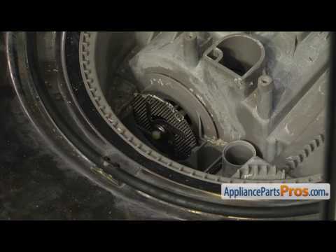

Thomas H Idaho Falls , ID July 07, 2015 Appliance: Model KITCHENAID 8 YEARS OLD OR SO Clogged at the chopper assembly strange noisehopper assembly broken Looked at Dishwasher. Scratched head and armpit. Told wife I would fix, not repariman. Wife skeptical - shook head. Found schematic on web. Found YouTube video of guy repairing same DW model. Disassembled. Diagnosed problem. Chopper assembly welded in place by water scale -broke removing. Potty mouth. Ordered parts. Waited for parts. Washed dishes by hand. Wife doing ok. Parts arrived (in only a day or two!!! Fed Ex for 7 bucks!! Great deal). Put on nasty t-shirt, baggy shorts. Leaned over to fix DW. Showed butt crack. Wife rolled eyes, left room. Sweated, scraped knuckle, took break, made sandwich, checked out SportsCenter. Dropped screw down hole near the motor. Potty mouth. Wife shaking head. Jumped in car. Acquired Coke, bag of Funyuns. Harbor Freight Tools - acquired telescopic magnetic screw-go-getter-thingey (and other cool stuff I didn't need). Arrived home. Retrieved screw - magnetic thingey rocked!!! . Scrubbed disassembled area with Vinegar. Installed new chopper assembly and protector. Reassembled. Turned on DW. Purred like first car - cherry 1968 Camaro. Showed wife fixed dishwasher. Flexed biceps, stuck out chest, sucked in stomach - baggy shorts dropped to ankles. Wife laughed. (ok, kidding). Presented new silverware basket to wife. (Bottom of old one worn out - silverware would fall through). Obtained hug from wife. That night, dinner, hugs, kisses. Life is good. "Weekend Warrior - Kickin' Butt, Takin' Names" Read More... 26 People found this story helpful Do-It-Yourself Rating: Repair Time Estimate: 2+ hours Tools: Pliers, Screwdrivers
Kyle B Goldsboro , NC September 19, 2014 Dishwasher was making a loud noise during the wash cycle This grinder blade is located on the bottom of the dishwasher under the spray jets. So I removed the sprayer and the screen at the bottom of the wash area. The blade on the shaft just pills out. I installed the new one making sure it is seated in the groove. This was an easy job and the dishwasher is back to acceptable volume. Read More... 19 People found this story helpful Do-It-Yourself Rating: Repair Time Estimate: 30-60 minutes Tools: Screwdrivers, Socket Set

Joseph B Hastings , NE August 03, 2015 Appliance: KitchenAid Undercounter Dishwasher KUDS30SXWH1 My dishwasher was not cleaning the top rack items I did a little searching on the internet and found that the main problem was the food grinder screen gets plugged up. I watched a video showing how to take it apart ( I highly recommend watching) and was able to get to the part in about 2 minutes. I found the screen to be plugged but the grinder was also ruined from some broken glass that had gotten into it. I ordered the grinder and cover housing and installed them. Works like new again. Very easy repair. Watch the video and it will save you a lot of time. Read More... 3 People found this story helpful Do-It-Yourself Rating: Repair Time Estimate: 15-30 minutes Tools: Pliers, Screwdrivers
