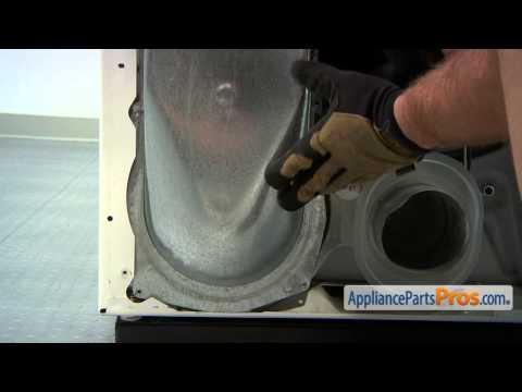

James C New Boston , MI July 20, 2017 Appliance: Whirlpool Gas Dryer LGR7646EQ2 Gas dryer did not heat and excessive lint inside the unit Our 19 year old Whirlpool dryer quit heating. After checking the thermal fuse, I found the ignitor electrically open. I bought an ignitor at a local store as there was a national holiday the next day and I did not want the dryer inoperative waiting several days for shipping. I can say AppliancePartsPros is MUCH cheaper for the identical Whirlpool genuine part. While changing the ignitor, I noticed there was an excessive amount of lint in the dryer, which was caused by worn drum seals. I ordered drum seals, a new drive belt, the foam seals for the exhaust duct and new nylon drum bearing set. These were delivered promptly, but unfortunately the 2-piece nylon drum bearing set had only 1 piece. I went on line, used the chat function and was promptly taken care of. The new part arrived fairly quickly, was correct and I installed it. The most difficult part of the project was the rear drum seal which must be glued to the drum. I removed the old seal and sanded off the dried glue. I then set the drum up on a work table, blocked from rolling off with 2x4s, so I could rotate it in place. The new seal needs to be stretched to make it around the drum circumference, so I used small wood clamps to hold it in place around the drum. I then pushed back the fabric, applied a small bead of glue to the drum surface, gave it about a minute to air dry, then repositioned the seal. I worked my way around the drum, rotating it on my work table. The seal installed nicely. Pay attention when you position the drum during final assembly so that the rear support rollers are in place and the seal correctly circles the stationary back wall for the drum. You can check the seal for folding bouth outside and inside. 2 people are advised for this step. One last note, the installation of the drive belt is little tricky, so photograph the belt path through the tensioner and motor drive pulley before you remove the old belt. Read More... 522 People found this story helpful Do-It-Yourself Rating: Repair Time Estimate: 1-2 hours Tools: Nut Drivers, Screwdrivers, Socket Set
David H Santa Clarita , CA September 20, 2019 Appliance: Whirlpool Gas Dryer LGR5620KQ1 Squeaky noise and not fully drying Originally the dryer was squeaking a lot, so I purchased a new belt tensioner, but the original tensioner was an old-style no wheel tensioner, so that wasn't the source of the squeaking. I saw a lot of lint had built up inside the unit where there shouldn't have been that much. So I viewed a few videos on the Appliance Pros site and saw that the rear wheel guides were the cause of the squeaking and the rear felt drum and blower housing seal needed to be replaced. The rear blower housing was very easy (watch video), the new felt drum seal was another story. I saw a post where someone said they used clamps to hold the felt in place due to the fact that the felt needs to be stretched. I dry fitted the felt with clamps and saw just how tight it was. I removed the felt and applied the adhesive as shown in the video. The problem is you need to work fast so I had a little trouble with the last 12-18 inches since I was clamping sections so it wouldn't pull off as I stretched the felt into place. If I was to do it again I would not apply the adhesive to the last 12-18 inches until I got the felt in place and clamped, then apply adhesive to last section and stretch the felt in place. The adhesive sets up pretty quick. The replacement of the tensioner, rear roller guides, drum belt and light bulb were just as shown in the videos. If it wasn't for the Appliance Pros site I would have went out and purchased a new dryer. So for a little less the $100 the dryer is running like new and clothes are dry at the end of all runs so far. Read More... 30 People found this story helpful Do-It-Yourself Rating: Repair Time Estimate: 2+ hours Tools: Adjustable Wrench, Nut Drivers, Pliers, Screwdrivers

John R Baldwin , NY August 16, 2015 Appliance: Kenmore Dryer 11086878100 Lent/blower housing seals shot Well, my Kenmore dryer being an older model, I had to access the housing shoot by first removing the drum. Newer models all you need do is remove rear panel. After that removed shoot, cleaned mating surface, and applied new foam seal. Your video covers it pretty good. Also, you timely delivery of needed parts expedited the situation. Read More... 2 People found this story helpful Do-It-Yourself Rating: Repair Time Estimate: 30-60 minutes Tools: Nut Drivers, Screwdrivers
