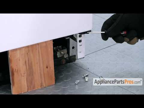

Gerald G Boylston , MA December 02, 2014 Refrigerator door not closing properly Ordered the upper and lower door cams - both live on the hinge at the bottom of the door. Repair took just a few minutes. Four 5/16 machine screws need to be removed and replaced to complete the repair. My door is slightly different from the one in the video. One thing that I learned from the video was to prop up the door with a block of wood before starting repair. I don't think I would have thought about that if I hadn't watched the video. For that reason alone, I buy my parts from AppliancePartsPros.com. Read More... 95 People found this story helpful Do-It-Yourself Rating: Repair Time Estimate: Less than 15 minutes Tools: Socket Set

Cindy F Dallas , NC April 29, 2014 Appliance: Whirlpool Refrigerator ED5FHAXST01 The door wouldn't close easily it was supposed to swing closed on its own but it wouldn't close unless you pushed it hard The video on the page where I purchased the part was very helpful. I thought I would have to remove the door to fix it, but the video showed how to put a board for support under it and change the part without removing the door. The refrigerator the video did the repair on wasn't exactly like mine, but I was able to figure it out. I removed the screws to take off the hinge and had to remove the door stop since one of the screws was holding in the door cam. I used a screw driver to work the old cam out of the door, just like the video suggested. It works great now! Read More... 25 People found this story helpful Do-It-Yourself Rating: Repair Time Estimate: 15-30 minutes Tools: Screwdrivers, Socket Set
