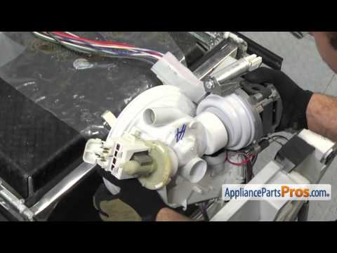

Steven J Los Gatos , CA October 08, 2017 Appliance: Model SHU9955UC/11 Bosch dishwasher would not move any water Repair estimate was $250 parts, $250 labor to change out the circulating pump. I decided to do it myself. Pump was $166 from AppliancePartsPros. It arrived in 4 days. I looked at the video on their website, followed the instructions step by step and did it myself. They estimated 45 minutes. It took 2 hours.There are always minor differences so always take photos of yours. Suggest that you bag up all screws and pieces from each part as you take them off and label the bag. I had 12 bags with 2 to 8 screws in each. At the end I had no leftover parts or screws. I already had the required tools. I also labeled every part that came off as left, right, upper, lower, front, back. This will save you lots of aggravation. Dishwasher worked like a charm. I might also suggest that you test the machine before putting it back just to make sure everything works and there are no leaks. And wear gloves. There are lots of sharp edges. The only slightly unusual tool you might not have is a torx #20 screwdriver. Read More... 12 People found this story helpful Do-It-Yourself Rating: Repair Time Estimate: 1-2 hours Tools: Pliers, Screwdrivers, Socket Set
Kurt T Naperville , IL October 17, 2016 Appliance: Bosch SHU9952 UC/12 (FD 8105 -) Circulation pump was failing or had failed was making an unusual cyclical noise and not spraying dishes Bought a replacement pump from AppliancePartsPros.com and watched their repair video once to prepare, and then walked through it step-by-step as I was going through the repair myself. The video was pretty good- my model wasn't exactly the one pictured- mine appeared to have some additional shielding/protective pieces on the sides of the dishwasher that restricted access to some of the wiring and required me to do things slightly differently than the video showed, but it provided a good overall guide as to how to progress throughout each step of the repair. Ran into one additional snag- the video shows a hose clamp used to secure the connection between the circulating pump and the sump, but mine had a one-time-use pinch clamp. I had to run to the hardware store to get a new clamp to use there. I replaced with a worm drive hose clamp, rather than another crappy pinch clamp. Overall, this is a fairly involved repair, but it's definitely doable for a handy DIY type. Took me about 4 hours, including the trip to the store. Read More... 11 People found this story helpful Do-It-Yourself Rating: Repair Time Estimate: 2+ hours Tools: Screwdrivers, Wrench Set

Robert M Seattle , WA October 12, 2018 Appliance: Model SHU5312UC/U12 Circulation pump failure. Ordered new part from AppliancePartsPros.com and received exactly what was identified. Had no problem following the instructions from the video offered on their web site. The video was missing instructions concerning removal of the side panels, but I have done that before. I am very happy with my experience and would definitely order from them again. Note: My dishwasher needed the Torx #20 screw driver for all screws. Read More... Do-It-Yourself Rating: Repair Time Estimate: 2+ hours Tools: Screwdrivers
