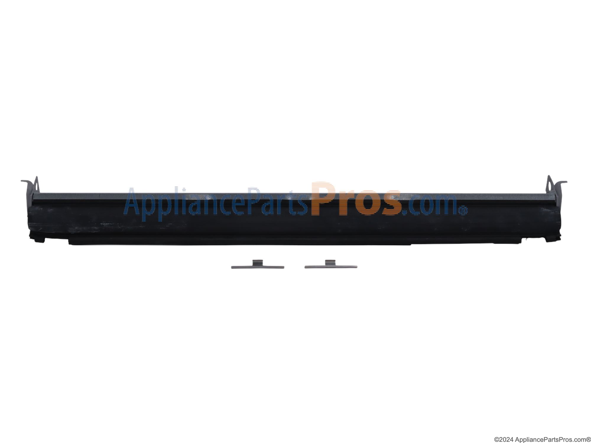

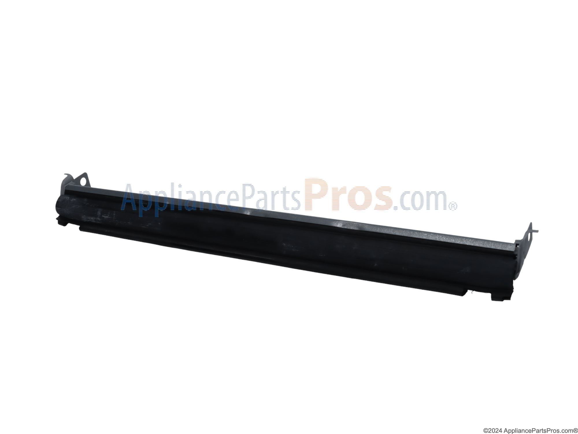

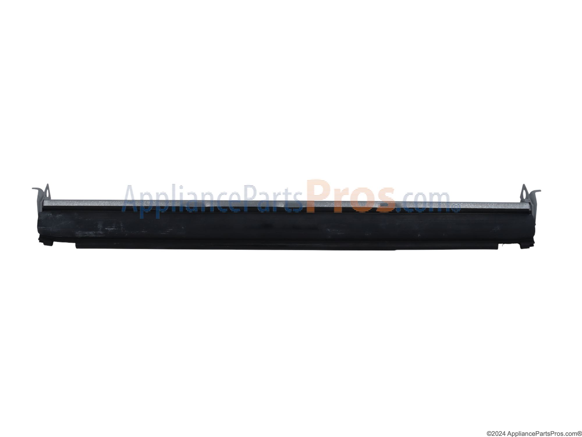

William A Mountain City , TN June 29, 2020 Appliance: Bosch Dishwasher SHXM78W55N/01 One of the seals end brackets had worn through The repair included pulling the unit from under the counter,removing the door, removing the old seal and replacing with the new seal which fit perfectly. This repair was made much easier by viewing the video that was available. Read More... 3 People found this story helpful Do-It-Yourself Rating: Repair Time Estimate: 30-60 minutes Tools: Screwdrivers
Jim F Fairfax Station , VA April 12, 2020 Broken lower door seal on dishwasher/ I fixed it using the appliance parts pros video and by ordering the part form them. Read More... 3 People found this story helpful Do-It-Yourself Rating: Repair Time Estimate: 30-60 minutes Tools: Pliers, Screwdrivers
