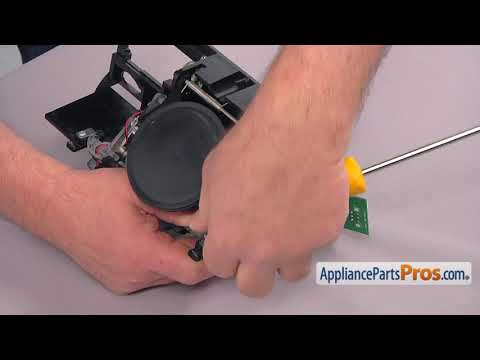

Armand B Monroe , LA February 23, 2015 Appliance: Model FRIGIDAIRE SIDE BY SIDE Ice dispenser broken; plastic arm that trips micro switch had broken off & hinge point broken Removed complete housing, including the actuator to dispense ice; plastic cemented, with reinforcing strips of cloth to reinforce repair on left hand side of assembly. Then installed new actuator part from Appliance Parts, plugged in wires, then had to plastic cement the pack on back of the new actuator back on, as it had come loose. Reassembled all, and finally managed to get the water discharge tube back through the hole, than replaced the flat strip connector & replaced all screws. Works great! Read More... 3 People found this story helpful Do-It-Yourself Rating: Repair Time Estimate: 30-60 minutes Tools: Pliers, Screwdrivers
Junius C Madison , MS June 14, 2015 Water dispensor handle brokin and ice maker dispensor not working right Replaced both parts. only problem was reconnecting the water dispensor tube- was cut so short had trouble getting it back in the hole. Read More... 2 People found this story helpful Do-It-Yourself Rating: Repair Time Estimate: 30-60 minutes Tools: Pliers, Screwdrivers
Michael L Naperville , IL November 11, 2016 Appliance: Model USE THE CORRECT REFG MODEL #TO LOCATE THE CORRECT Ice dispencer lever broke Very important to watch the on-line video showing the suggested steps. However, it was never mentioned that there is a wire hook-up for the ice dispencer actuator wich also needs to be plugged in. Simply remove the old wire clip and re-attach the new one in the same slot. Also found out during the proceedure that the pin for the ice shoot door had disengaged and had to be pressed back in the hinge to get full functionality of ice the dispencer door closure. This also greatly improved the overall dispencer operation."just like new". Read More... 1 People found this story helpful Do-It-Yourself Rating: Repair Time Estimate: Less than 15 minutes Tools: Pliers, Screwdrivers
John D Medford , NJ January 21, 2020 The paddle on my ice maker door was broken I ordered the part and followed the video. It was quite simple and works like new. Read More... Do-It-Yourself Rating: Repair Time Estimate: 30-60 minutes Tools: Pliers, Screwdrivers
James L Monroe , GA November 03, 2015 Appliance: Frigidaire Refrigerator GLHS69EHSB3 The paddle that you push down to dispense ice was broken off The repair was made easy by a tutorial that I watched before I started. The video showed exactly what to do and what precautions to watch out for. The estimated time to complete the repair was given as to take 30-60 minutes. That was accurate as mine took about forty five minutes. I suggest to anyone who is going to make this repair to watch the video. It will save you from guessing and possibly from breaking something. Read More... Do-It-Yourself Rating: Repair Time Estimate: 30-60 minutes Tools: Pliers, Screwdrivers
