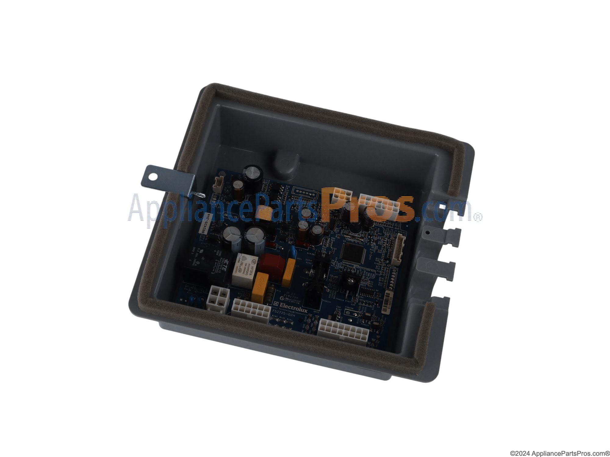

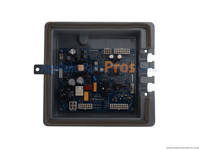

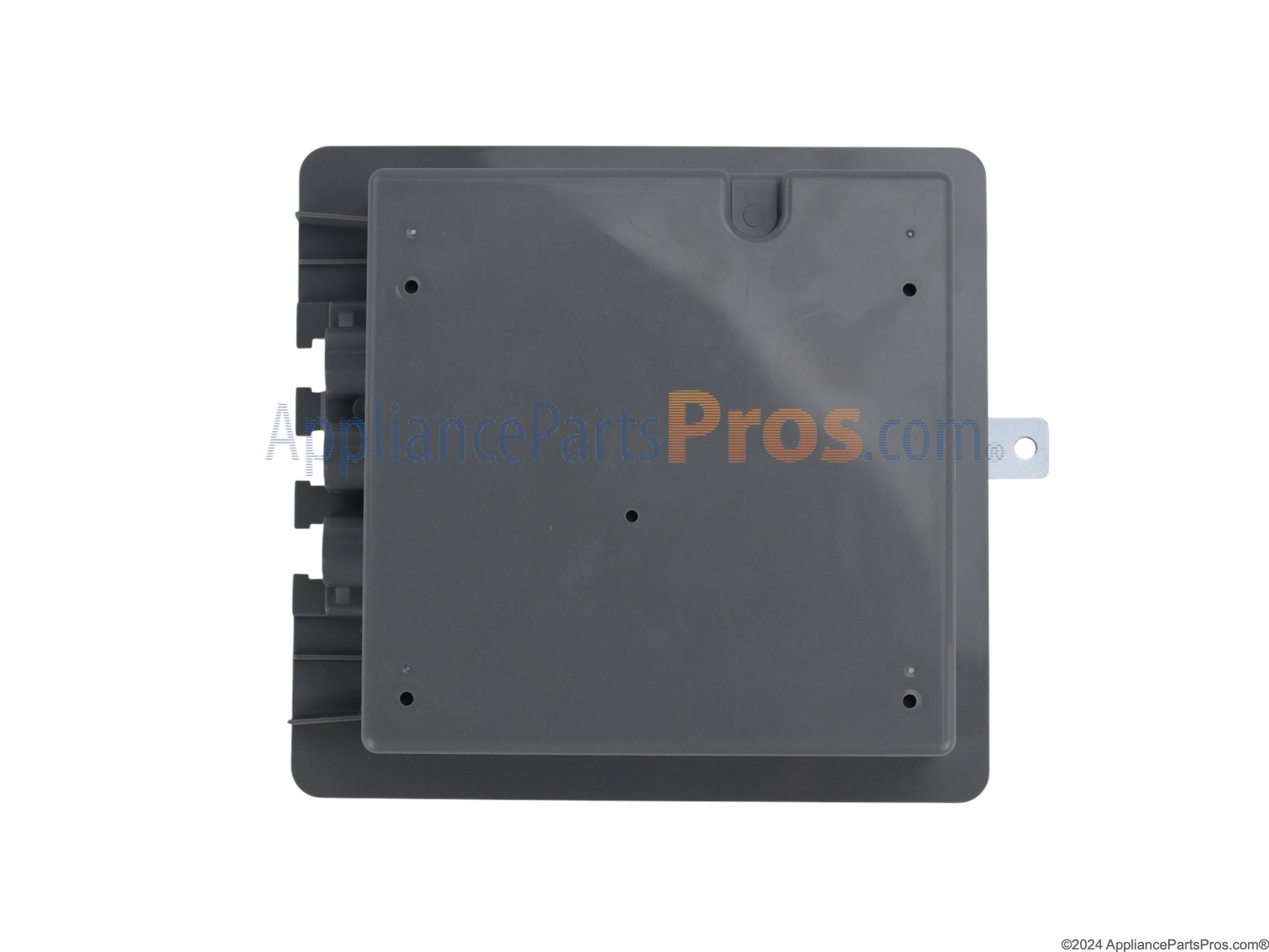

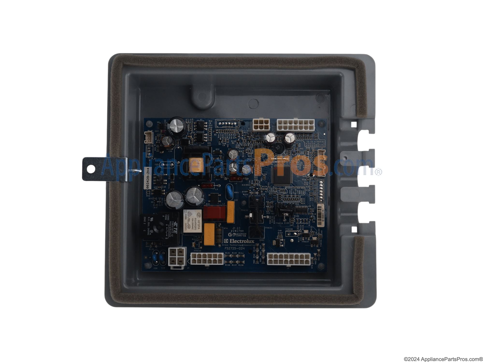

Rod K La Crescenta , CA September 11, 2017 Refrigerator would not defrost I measured the continuity of the defrost heater element and the thermostat and they were both good. This only left the main control board. I ordered all three because it was only a matter of time before either the heating element or thermostat went bad. I only changed out the control board and now have the other parts on hand for an immediate fix in the future. Appliance pros were awesome. I paid just a little more for the faster shipping and got the parts the next day even though I expected 2 day minimum. The website is great. Plug in your model number and it will tell you part compatibility and search out for all compatible parts. Awesome feature. Put a couple of 2x4s under the refrigerator to elevate it and make it easier to get the control board out. I used a crowbar to lift the refrigerator to place the 2x4s. Defrost problem fixed ! Read More... 23 People found this story helpful Do-It-Yourself Rating: Repair Time Estimate: 15-30 minutes Tools: Nut Drivers, Screwdrivers
Cecille N La Puente , CA December 26, 2017 Sy ce show on display panel and water valve inlet Unplug power cord of appliance, make sure no access for kids to reach. Removed kick panel on the front, reach the gray box. Make sure to use 1/4 socket that holds the box to the metal bracket. Carefully slide forward. Make sure it does not damage the cord behind it. Take a picture before you unplug the cord, press the tab and pull straight. Replace with new main control board. On the water valve inlet, make water line is shut off just on the sink or where ever your water source for the fridge. Take a picture before you dismantle the replacement water valve inlet. Just be care not to damage the hoses. Grab a good cutter to use. Always follow safety tips. Good luck, you can do it too to avoid costly labor repair. Read More... 2 People found this story helpful Do-It-Yourself Rating: Repair Time Estimate: 15-30 minutes Tools: Screwdrivers, Socket Set
Dorothy R Middleburg , FL June 01, 2019 Appliance: Frigidaire Refrigerator FGUS2642LF2 SY CF error code probably due to a power surge Replaced both computer boards. The main board was a bit of a challenge to remove solely based on the refrigerator placement in the kitchen but the videos I watched prior to the job helped tremendously. Read More... 2 People found this story helpful Do-It-Yourself Rating: Repair Time Estimate: 15-30 minutes Tools: Screwdrivers, Socket Set
Robert L Green Bay , WI April 17, 2021 Appliance: Frigidaire Refrigerator FGUS2642LF2 Intermittent sy ce and sy cf error codes. I searched the web for explanations of the error codes, found the answer on your website, watched your excellent video showing how to replace the control boards, and knocked the job out myself in 20 minutes! Read More... 2 People found this story helpful Do-It-Yourself Rating: Repair Time Estimate: 15-30 minutes Tools: Pliers, Screwdrivers, Socket Set
Marvin M Doerun , GA February 10, 2020 Appliance: Frigidaire Refrigerator LGUS2642LF2 Water dispenser quit woring but all else worked fine Rick on the Frigidaire appliance repair blog identified the main control board as the issue. I replaced it and the problem was fixed. Read More... 1 People found this story helpful Do-It-Yourself Rating: Repair Time Estimate: Less than 15 minutes Tools: Screwdrivers, Socket Set
