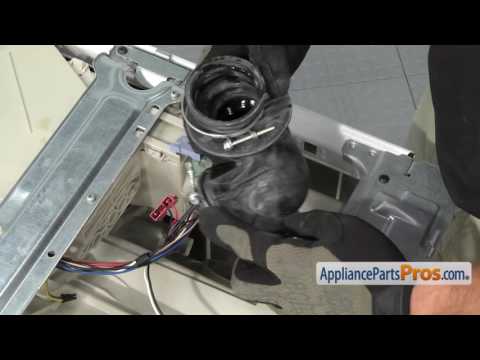

Carolyn S Venice , FL December 05, 2016 Appliance: Model FRIGIDAIRE AFFINITY FRONT LOADER Washer was leaking First of all, I want to say that this is not the first time that I have used AppliancePartsPros. They give you everything you need in the most simplified manner to repair your appliances at home. I ran my washer until I started to see the leak coming from underneath. After verifying that the intake hoses, drain hose and pump were not leaking, I opened up the washer from the top by unscrewing the two screws on the back brackets and lifting up and out. Because the leak was displaying at the back left on the floor, I checked the dispenser hose going to the tub and there was a small tear in the elbow area. I removed the torn hose and entered in my model information into the APP website. They not only had the part but a detailed video on replacing the hose. Even though I took out the hose without removing the dispenser, I had to remove it to put the new hose in because of the tight work area and the angle at which the hose clamps have to be tightened. The dispenser hoses must be removed first and then disconnect the electrical connections on the dispenser tubes. There are a few screws that must be removed on the top and bottom and then shimmy it back and up to remove. I almost removed the plastic vent tube for extra work space. Wetting the new hose ends along with the receiving ends will help slip the hose on. Make sure the hose arrows line up at 12:00 on the tub side and also make sure the angle of the hose brackets leave you in a position to tighten them down. I used a small open wrench on the dispenser side and a nut driver on the tub side. Voila! Thanks Appliance Parts Pro for helping this woman fix her own appliances! Read More... 8 People found this story helpful Do-It-Yourself Rating: Repair Time Estimate: 1-2 hours Tools: Nut Drivers, Pliers, Screwdrivers, Socket Set, Wrench Set
