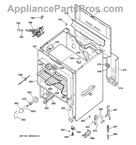

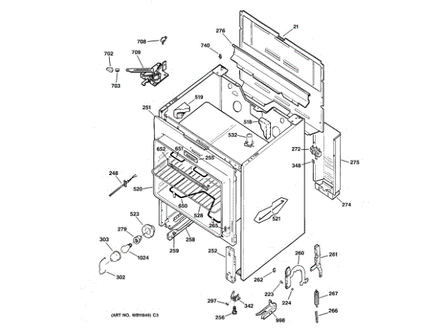

David S Grafton , WI August 16, 2016 Appliance: Model GE RB526V4 Our stove element burnt out and actually started a small fire while broiling some chicken breasts The 1st thing I did was look up the model # of our Hot Point stove then Googled it and found ApplianceParts Pros.com.I typed in our # and it brought up our model with an easy to read drawing which listed our exact broiler part.I also downloaded a few YouTube videos that explained a # of different manufacturers models and how to replace their broiler coils. What I found most interesting was how to remove my oven door which really made removing and replacement of the part a snap.I also greatly appreciated after ordering one day,getting my part on my porch the VERY NEXT DAY. It fit like a glove and we were back to using our stove and could not be happier.The price was reasonable and getting the part quickly in my opinion made this an Ideal DIY project. Read More... 1 People found this story helpful Do-It-Yourself Rating: Repair Time Estimate: 15-30 minutes Tools: Nut Drivers, Screwdrivers
