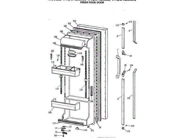

John H Baldwinsville , NY August 09, 2014 Appliance: General Electric Refrigerator TFX20DLB Refrigerator door was binding as it closed; would not close on its own I determined that the cam riser had broken into two pieces. Finding the part was easy on the diagram on the website. It arrived less than 24 hours after it was ordered. Top hinge was removed and the door was placed on a set of horses. One bolt was removed from the bottom of the door, the pieces of the broken cam riser were removed and the new one installed. Door was replaced and top hinge rebolted. The door was off for about 5 minutes. I was very pleased with the service of Appliance Parts Pros. Read More... 30 People found this story helpful Do-It-Yourself Rating: Repair Time Estimate: Less than 15 minutes Tools: Wrench Set
Edward V Shoreham , NY September 27, 2014 The refrigerator door would not open properly without making a banging noise because the plastic riser at the bottom had broken off after 12 years of use ! It was very simple. I googled for "parts to a GE side by side refrigerator and I found the website for Appliance PartsPros.com. I then googled their site with the refrigerator mode number and a list of all possible parts appeared with schematics. I ordered the part and in a couple of days it arrived. I removed the door and looked at the schematic as to how it was to placed with the other parts, and it was fixed in less than 20 minutes - from start to finish. Thank you Appliance PartsPros.com - you saved me the expense of replacing the refrigerator, or at least $150 dollar service call by a repairman ! Read More... 9 People found this story helpful Do-It-Yourself Rating: Repair Time Estimate: 15-30 minutes Tools: Screwdrivers, Wrench Set
