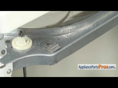

Alan W Oklahoma City , OK December 27, 2021 Appliance: General Electric Washer GLWN2800D1WS The tub wobbled badly during spin cycle on GE washer. YouTube video indicated worn-out stabilizer straps (4) at top of the tub needed replacing. Ordered from AppliancePartsPros.com, and got them the next afternoon. Repair required two sizes of nut drivers and about 45 minutes of time to replace the 4 straps. Washer worked like new again after repair and saved me about $200 for a service tech call. Parts cost me about $8 each X 4. The previous tech had mangled the front panel locking clip so I replaced that while I had the front and top off. Another $8 was well spent as it eliminated the annoying rattle of the front panel. Have used AppliancePartsPros twice now and they've gotten me the parts overnight both times. Right parts... reasonable price and great service. Read More... Do-It-Yourself Rating: Repair Time Estimate: 30-60 minutes Tools: Nut Drivers
