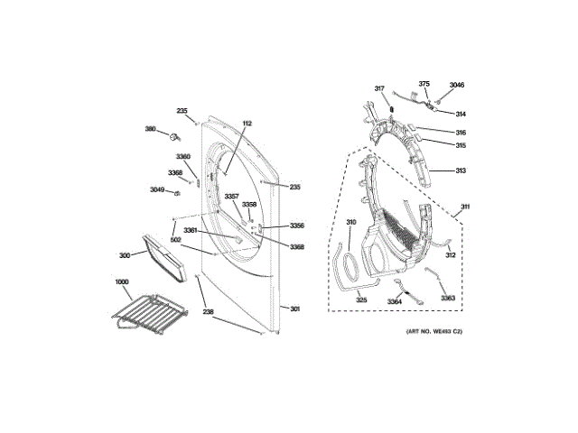

Curt C Jackson , MI September 02, 2015 Appliance: General Electric Electric Dryer DCVH660EH0GG Felt trap duct dislodged from slot and bearing slides and rear drum sleeve worn Selected and ordered parts from online drawings. Watched videos showing how to make repair. Replaced worn parts with new ones. Suggested improvement: Videos didn't show my model (I know there are many models, showing all is probably not possible). In case of Felt the video showed a Maytag dryer when my model was GE. In my case Felt had torn and dislodge from slot so I didn't know exactly how it should be installed. A simple picture of the installed Item would help. Also the parts list should give number of each item required. The bearing slides require 2 of each type, the drawing only shows one and the parts list doesn't say 2 required. Other sites did specify this. Read More... 8 People found this story helpful Do-It-Yourself Rating: Repair Time Estimate: 30-60 minutes Tools: Screwdrivers
