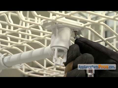

Becky L Gainesville , FL March 25, 2016 My ge dishwasher center arm wasn't spinning I ordered a new arm kit from AP Pro. I watched the video..easy repair. The arm spin jets were plugged just like the video said. The old washer was also worn. The new arm (genuine GE) had redesigned spin jets, they added two more. I ordered on a weekend, the order was filled on Monday and it was at my door at noon on Tuesday! I didn't do any special shipping. Excellent video, shockingly fast delivery. Amazon Prime (I am a member) would be jealous, and AP Pro has excellent videos. Read More... 10 People found this story helpful Do-It-Yourself Rating: Repair Time Estimate: Less than 15 minutes Tools: Nut Drivers
Kriss G Washington Grove , MD April 09, 2016 Broken middle spray arm on ge dishwasher Ordered the Middle Spray Arm Kit from AppliancePartsPros, delivered in two days, removed two screws, replaced the broken spray arm, and replaced with two new screws provided in the kit. Very easy and everything fits and works great - we're back in business in 15-20 mins. Read More... 5 People found this story helpful Do-It-Yourself Rating: Repair Time Estimate: 15-30 minutes Tools: Nut Drivers

Beth S Grand Rapids , MI October 12, 2015 Appliance: Model GE TRITON DISHWASHER Dishes were not getting clean Decided to replace the fine filter assembly and along with it the lower and middle spray arm. I have tried cleaning these with a tiny brush and was able to remove some gunk out but they do not come a part so thought it best to just start with new. The filter and lower spray arm were easy to just take off and the new just fit right in. The middle spray arm part was a little different then the original. It comes with a new metal screw and washer and a plastic part that is attached to the bottom of the upper rack. You have to remove the old part that is held on by one screw and attach the new part so that the spray arm fits. Not sure why they would change it since the old set up seemed fine but you have to either take the whole upper basket off its track and out or try to work upside down. I opted to take the basket out by prying the plastic end pieces out of the track and sliding the basket out. It was an easy fix and now my dishes are clean with out a film and dirt residue left on them. Read More... 2 People found this story helpful Do-It-Yourself Rating: Repair Time Estimate: 15-30 minutes Tools: Screwdrivers
