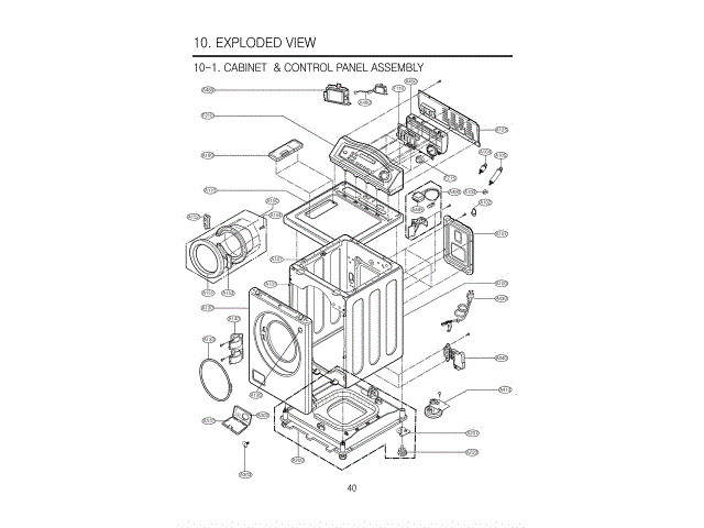

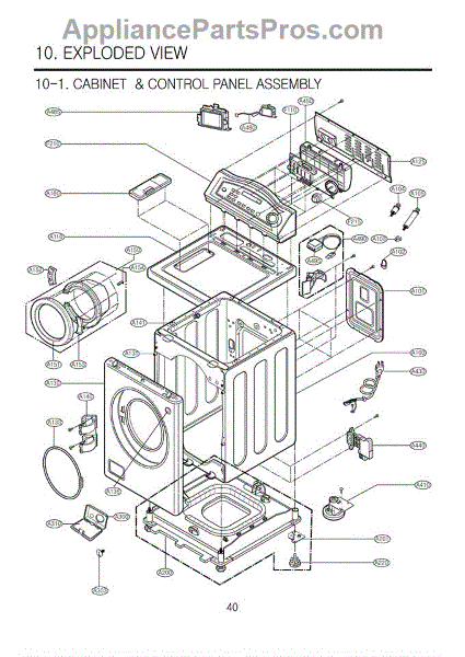

Alan H Elizabeth , PA October 03, 2016 Appliance: LG Washer WM2077CW Ue error with 10 mins left in cycle I read some stories on here. My problem was very similar. We got the UE error with about 10 mins left in the wash. I reviewed diagram on here for the part and had easiest appliance repair. This was a no headache fix. just screw the top, back and then part. 7 screws in and out. Its that easy. Read More... 3 People found this story helpful Do-It-Yourself Rating: Repair Time Estimate: 15-30 minutes Tools: Screwdrivers

Robin S Decatur , IL February 08, 2016 Appliance: LG Washer WM0642HW Error code ue I called a service repairman out. His diagnosis was the sensor assembly was bad. He called around 3 hours after he left and said LG had discontinued that model washer, so the part was discontinued too. So I went shopping for a new washer when the store employee recommended I describe the problem and the part to their employee at the parts counter of their store. She said parts are usually still available till the appliance is10 years old. Well he couldn't figure out that part I was describing (because he didn't have the right diagram), so that encouraged me to search online. Oh how I 'm glad I did. I found the part thanks to your website and the great diagram of the washer. Ordered it, received it the next day, my husband installed. Saved us lots of bucks .Love this place !! (service repairman must not no about internet ) Read More... 2 People found this story helpful Do-It-Yourself Rating: Repair Time Estimate: 15-30 minutes Tools: Screwdrivers
