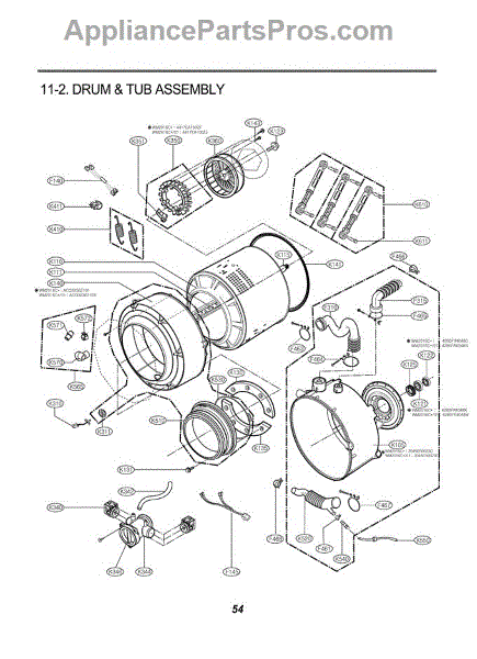

Carmelo C Northampton , PA June 22, 2015 Broken spider shaft replace worn bearings and springs and door boot and shocks Watch the video on youtube from appliane parts pros step by step how to take apart and replace all parts great video. Read More... Do-It-Yourself Rating: Repair Time Estimate: 1-2 hours Tools: Adjustable Wrench, Pliers, Screwdrivers, Socket Set
Pete L Bossier City , LA February 20, 2022 Appliance: Model WM2016CW/00CW Hinge spring. Refited rear shock which had come apart and replaced springs. Only 1/2 load run so far with no code. Here's hopeing for another years worth of washing. Thank you AppliancePartsPros for the spring. Wish you supplied the removable water inlet screens. Read More... Do-It-Yourself Rating: Repair Time Estimate: 30-60 minutes Tools: Adjustable Wrench, Screwdrivers
Mark C Lake Oswego , OR March 31, 2020 Extreme shaking. No luck, I did the easy fixes first by replacing the shock absorbers then the springs to no avail. Looks like the problem is in the much more expensive and difficult spider arm. Read More... Do-It-Yourself Rating: Repair Time Estimate: Less than 15 minutes Tools: Screwdrivers
Eric H Niskayuna , NY February 26, 2017 Appliance: Model LG WM2016CW Burning smell Replaced all bearings, seals, springs, dampers and gaskets. After disassembly I was cleaning the gunk off the spider arm. I was seeing what looked like small stones in the clean out trap. Turns out it was small pieces of metal. Spider arm was being eaten and had holes in it so replaced that too. Bolts holding spider arm to the drum are secured with orange lock tight. I used blue when replacing. Burning smell is gone along with all the other smells after 9 years of use. Rubber door gasket seems to not fit the same as the original. Not leaking and fits snuggly to the tub and door just more rubber in the folds. Not sure how else to describe it.There was a little rubbing because of this below the upper hold back tabs on spin cycle but that seems to have stopped. All parts were correct for my unit and arrived quickly within 2 days. Read More... Do-It-Yourself Rating: Repair Time Estimate: 2+ hours Tools: Nut Drivers, Pliers, Screwdrivers, Socket Set
