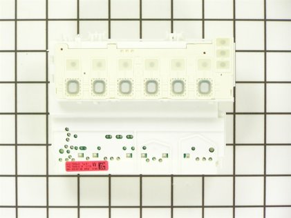

Robert for Model Number Bosch SHE55M15UC/64
No heat, dishwasher runs for about 30 mins then adds some random amount of time to the time remaining display, then continues running all the way down to 1 minute remaining and continues running w/1 minute remaining without ever stopping. I have to turn it off. Dishes don't come out clean. I am pretty sure a control module will fix it. However, what the heck is the difference between the "control module" (AP4501085, part 101 in the diagram) and the "module-control" (AP4298189, part 112 in the diagram)??? And which one should I order?
1 Answer
Robert, the control module 00676963 is going to be the main control while the module 00641945 is the timer display. It is possible that the main control module could be the cause of failure, however, the only way to verify this would be testing the heating circuit and thermistors to identify if they are good.
Read More...
Philip for Model Number SHU5312 UC/06
First, I replaced the soap dispenser. Then, the DW would not run. Got error code 4. Replaced the inlet valve. The old one was full of grit, so I was confident. Nope. Still error code 4. Then, I replaced the level switch. Same result. Then, replaced the pressure chamber. Same result. Finally, gave in and replaced the control panel. No error code 4 now, but the DW still doesn’t fill with water. The minutes will count down on the timer, but it isn’t washing. Signed....stubborn.
1 Answer
Phillip,
You will want to make sure that the water valve is connected and that the water is turned on with no kinking of the water hose.
