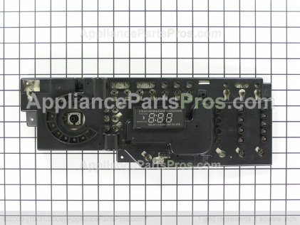

This genuine replacement part is a user interface board for dryers. The user interface board is the circuit board that responds to the buttons located on the control panel allowing the user to adjust the dryer settings. If the dryer is no longer responding when buttons are being pressed then it might be time to replace the user interface board. Luckily this is a relatively easy repair.To replace the interface board begin by turning off the power to the dryer. Once the power has been shut off move the dryer away from the wall to gain access to the upper back panel. Remove the panel and locate the interface board. Snap it out of its brackets and remove the wire harness attached to the board. Reinsert the wire connector to the new interface and snap the new board assembly back to its original place.This OEM replacement part is sold individually and is compatible with General Electric, Hotpoint, and RCA brand Dryers.

Wayne,
Yes the user interface board should be the only thing that would be needed for correcting the start button issue.

Alexandra for Model Number DCVH680EJ1WW
My dryer cycles are freaking out. All cycles stop mid cycle and then randomly start again. It does this on all the dryer settings. I noticed the problem the first time when I left my house with items drying and 4 hours later, returned to the dryer doing this start/stop thing. It had been running the ENTIRE time. (Scary because the clothes could have caught fire-- they were SO dry.) Should I replace the entire user interface board or replace some other part? A GE technician came out and charged me $100 to tell me that he thought it was the whole computer. He said to replace it would cost $600. After looking into fixing it myself, I am curious if I do need to replace the whole user interface or if I need to replace something different like a timer? I look forward to your feedback. Thank you.
1 Answer
Alexandra,
This issue would most likely be caused by a faulty main power board which will be part number WE4M488. When you remove the main top of the unit it will be located under the main top.

1 Answer
Adriana,
This issue would be caused by the housing on the user interface breaking and causing the button to not make contact. You will need to replace the user interface part number WE4M513.

1 Answer
Hello Cooldad,
This can be one of several issues. You could have a bad high limit thermostat, door switch, motor relay/board, motor, or a harness issue. WE4M513 will work on your unit.
