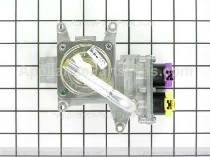

Bob July 02, 2021 for Model Number KGRS303BSS1 My oven will ignite, sometimes it gets to temp other times it just burns for 30 or 40 seconds and goes off, then repeats the same. I checked the coils on the gas valve, the reading I got on both was 227 ohms does that reading indicate they are bad? I know they are supposed to be 216 ohms
1 Answer Bob, The resistance reading that you are getting with the valve is consistent with being good since there is always a plus or minus 10%. But with that said if the burner is going off after 30 to 40 seconds then that would be more consistent with an oven safety valve that is faulty rather than any other issue. It would be recommended to make sure that the burners are nice and clean as well. Read More...

Bob March 12, 2019 for Model Number KGRS303BWH2 I have a Kitchenaid Range Model KGRS303BWH. When I turn on the oven for normal bake cycle, the oven igniter will activate and lite the oven, but in approx. 15-30 seconds, the oven will turn off. I have replaced the igniter about 3 weeks ago, and after replacing the igniter, the oven work normal for about 3 weeks, now it is doing the same as original problem. Any ideas?
1 Answer Bob, With the oven shutting off after 25 to 30 seconds this would be a faulty oven safety valve. Read More...
Sam May 18, 2017 for Model Number WFG540H0AE0 I have gas smell inside my oven. I don't smell it when the door is closed. I checked the supply with soapy water and there were no bubbles so I think the problem is with the oven. What would you suggest to replace first? Thanks
1 Answer Hello Sam, You will need to replace the safety valve WPW10602004. If you are on LP you will need to remove the bake and broil orifices from you old part and install them on the new part in the correct positions. This will convert the part to LP. If you are on natural gas you will not have to tamper with the part before installing is as it will come from the factory set up for natural gas. Read More...
Jim February 11, 2017 for Model Number MGR8674AW0 what should the ohm readings be of the coils of the safety valve w10602004? Thanks.
1 Answer Jim, Just like the original WP gas valve, the coils should have a resistance reading of 216 ohms resistance across the coil terminals, with the wires removed " Check between each solenoid for 216? resistance. (Measure between the two Broil valve terminals the two Bake valve terminals. NOTE: Always check both solenoids. If one of the solenoids is defective, neither one will work." Read More...
