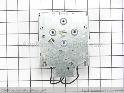

Sue R. January 30, 2012 for Model Number Maytag LAT8904AAE I replaced the Lid Switch Assemply which was necessary (blown fuse & switch) but now the water fills but doesn't advance (no agitating or spinning) is the timer in need of replacemnt? (The push/pull had been acting up for a long time but we were able to use the machine.)Also can the timer be checked if I take it out and have someone check with Ohms Meter? Thanks for all your help.
1 Answer Hello Sue. You will need to test for power coming to the timer motor WP22001024. If there is power there and the timer does not advance, you will need to replace the timer on the unit. You can test this with a multi-meter TJMA-DMT3. Here is a link on how to use a multi-meter. Hope this helps. http://forum.appliancepartspros.com/oven-repair-including-ranges-cooktops/4810-how-check-continuity-ohmmeter.html Read More...
Otto December 07, 2011 for Model Number lat8804aal My machine does not spin on its own and also when water is filling starts the agitation if door is closed. When knob is turned manually to where spin cycle would be sometimes will spin.
1 Answer Hi Otto. By the description of you can manually advance the timer to get the unit to spin, then it seems as if the timer internal cam contacts are shot. The timer is part # WP22001024. Thank you. Read More...
Grady K. June 25, 2011 for Model Number LAT 8824 AAE, Maytag washer How hard is it to replace the timer (Part # AP4026151) and how would I do it? Thanks, Grady.
1 Answer Hello Grady! Here are the instructions regarding the timer WP22001024 removal. You will install in the reverse order. Hope this information helps you!Timer Removal:1. Disconnect washer from power supply.2. Pry the cap off and pull the retainer clip off the timer shaft. Remove the timer knob, spring and dial.NOTE: The timer shaft pin is longer on one side. This is to prevent the dial from being installed incorrectly.3. Remove the two screws holding the timer in postion. *Note which set of holes the mounting screws are located in.4. Remove the two inside screws on the control panel and tilt away from the console.5. Remove wires from timer. NOTE: Always replace by wire number. Read More...
