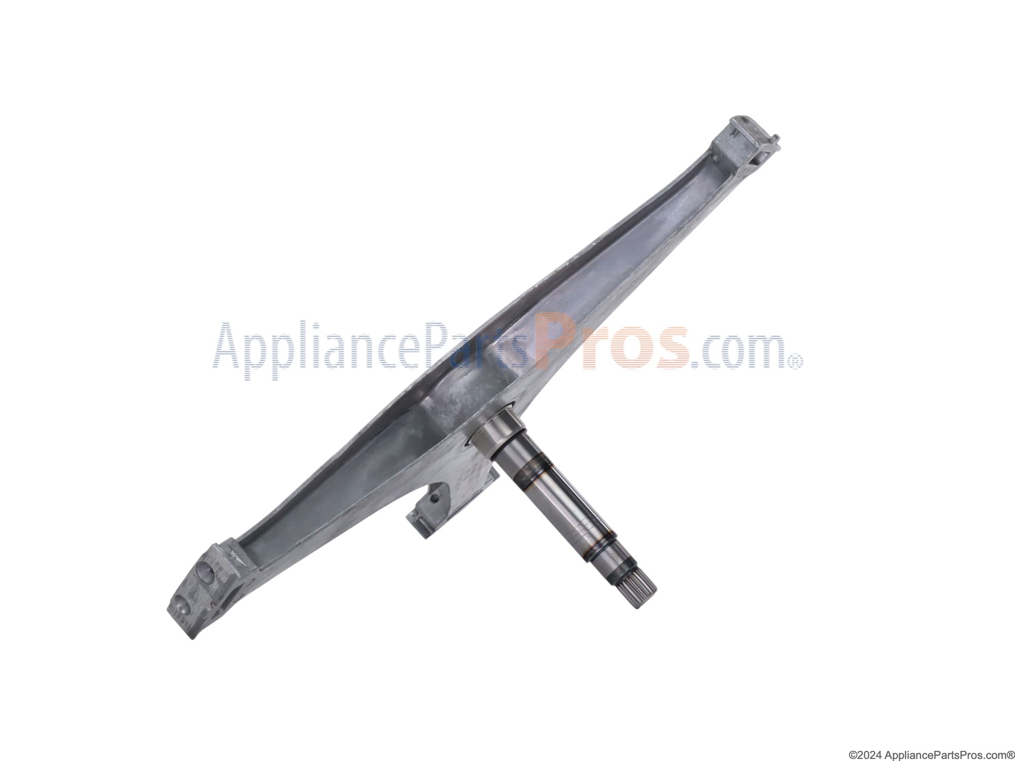

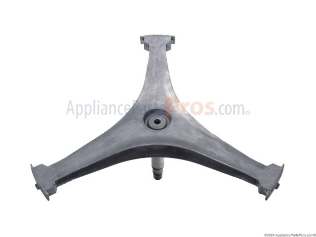

Lisa C Sumas , WA December 20, 2015 Appliance: Samsung Washer WF210ANW/XAA Corroded/ pitted/ broken drum support spider axle I noticed my 5-year-old Samsung, front-loading washing machine started to sound like my kids were using it as a drum kit. I immediately checked it out and the stainless drum was wobbling so badly that I just took it for an unbalanced load of clothes. My gut was telling me that something was wrong because I had not remembered the machine being so loud before. I removed the clothes from the washer and I ran it empty to confirm my suspicions: the wobble was still there. I would say it had a 2"-3" wobble from top to bottom, though not sideways. Having no alternative, I took the machine appart. Without getting into much detail, I will say that I had to remove the top, back, and front panels of my washing machine so I could get to the drum assembly. In order to remove the drum assembly, a few hoses, shock absorbers and finally the suspension springs need to be disconnected as well. I took the whole plastic tub assembly out of the machine from the front. I opened the plastic tub assembly, gained access to the stainless drum, removed it and discovered the drum axle support/ spider thing was so corroded, one of the arms/spokes had broken right off. I ordered the part from appliancepartspros and it arrived in two days, as promised. I washed the stainless drum, the plastic tub, installed the new part, and re-assembled the rest of the machine. My washer now runs normally again. I am glad I caught the problem early because I cannot imagine the damage it would have caused to other more expensive parts had I let it go. The bottom line is don't buy a Samsung washer unless you enjoy working on appliances. Also, I thought it a good idea to paint the new spider's arms with a corrosion-resistant paint or perhaps even powder-coating it so you don't have to replace the part every five years. Read More... 40 People found this story helpful Do-It-Yourself Rating: Repair Time Estimate: 2+ hours Tools: Screwdrivers, Socket Set
Richard S Garden City , NY March 13, 2019 Appliance: Samsung Washer WF210ANW/XAA Excessive vibration; failure to complete the wash cycle (but no error code) After doing research online, it became obvious that the symptoms were consistent with a broken spider arm. I found a very helpful video online from Appliance Parts Pros that provided an extremely clear step-by-step tutorial of how to replace the spider arm. Although my machine was a little different than the one in the tutorial, it was close enough to be instructive. I ordered a new spider arm from appliancepartspro which arrived in one day. I also ordered new bolts and a new seal. Following the video allowed me to replace the broken spider arm and seal. Realistically, it took me about 2 hours to disassemble the machine and remove the tub which incorporates the spider arm. It took about an hour to disassemble and thoroughly clean the tub and washer drum which was caked in gooey sludge (used a scrub brush and garden hose outside), swap out the spider arm and reassemble the tub. It then took another couple of hours to reinstall the tub and reassemble the washer. I was careful during the disassembly to take detailed notes. I also taped all the screws to the part/panel they came out of. Both of these actions simplified reassembly. All-in-all, the whole job took about 5 hrs. The washer now functions just as it did when new: no excessive vibration and efficient wash cycle. One cautionary note for anyone doing this job, my new spider arm came through with a fair amount of “casting flash,” i.e., razor sharp bits of aluminum along some of the edges of the part which were left over from the casting process. I would strongly urge care (and a good pair of work gloves) when handling the new part. In my case, I spent a few minutes lightly filing the worst of the casting flash off with a metal file to reduce the risk of cuts during the installation process. Otherwise, my experience was uneventful. Read More... Do-It-Yourself Rating: Repair Time Estimate: 2+ hours Tools: Pliers, Screwdrivers, Socket Set

Tommy B Wilmington , NC January 22, 2016 Samsung washer six years old sounded like it was going to explode on spin I watched the videos online then took it apart found the spider assembly was in pieces. So I ordered a new one and replaced it. Be careful with the bolts when removing assembly I broke the first one then used a map gas torch to heat the other five they came out fine. Read More... 11 People found this story helpful Do-It-Yourself Rating: Repair Time Estimate: 1-2 hours Tools: Adjustable Wrench, Nut Drivers, Pliers, Screwdrivers, Socket Set
Robert D Attleboro , MA June 16, 2015 Appliance: Samsung Washer WF210ANW/XAA The flange shaft corroded and broke on my samsung front loading washing machine the bearings were okay I ordered a new flange shaft from Appliance Parts Pros and replaced the defective part. The bolts that hold the flange in place were also corroded. Appliance Parts Pros had them in stock as well. Pretty much had to take everything apart to see/ fix the problem. I reused the original gasket in the plastic tub... it seemed okay and it isn't leaking. I will probably replace the rear section of the tub if the bearings go in the future. Getting the parts could not have been easier. Read More... 7 People found this story helpful Do-It-Yourself Rating: Repair Time Estimate: 2+ hours Tools: Pliers, Screwdrivers, Socket Set
