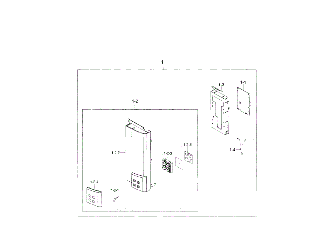

Philip J Cincinnati , OH November 04, 2014 Appliance: Samsung Built-In Microwave Oven SMH9207ST/XAA-0001 The buttons for the light and the fan were broken and inside the panel Removed the panel and removed and discarded the old parts, replaced the new pieces and reassembled the panel and the job was done and working like new. My wife is now a happy woman and that makes me happy also. Read More... 26 People found this story helpful Do-It-Yourself Rating: Repair Time Estimate: 15-30 minutes Tools: Pliers, Screwdrivers
Isauro D Suisun City , CA August 20, 2016 Appliance: Model SAMSUNG MICROWAVE SMH 9207ST Samsung microwave smf 9207st vent and light button pushed in After searching how much it would cost to repair, i felt i should just replace the microwave till one of the customer in the appliance repair shop told me to order the replacement button. I research and found that it was cheap to replace with basic tools. Ordered the parts, and it took me 20 minutes to replace. Removed two screws (top) holding the hood piece, slide it to the left and pull forward. Remove one screw holding the control board, lift and pull. Took pictures of all wire connection and remove the board, this will give you access to the part to replace. I also read the poor design and placed a small hard rubber to put behind the button board. Solid fix. Wife is happy so i'm happy too. Read More... 16 People found this story helpful Do-It-Yourself Rating: Repair Time Estimate: 15-30 minutes Tools: Screwdrivers
Tom S Charlotte , NC November 07, 2015 Appliance: Model SAMSUNG SMH9207ST Buttons for vent and light broke on samsung smh9207st Undid screws on top of front panel. Slid vent cover left to remove the panel. Undid screw on top right of fascis cover. Removed fascia to expose circuit board. Undid screws to separate circuit board from panel. Unclipped board. Took out old buttons, replaced, clipped in button 'clickers. Reversed all steps. About 30 mins and all good. Read More... 13 People found this story helpful Do-It-Yourself Rating: Repair Time Estimate: 15-30 minutes Tools: Screwdrivers
Louis P Lords Valley , PA September 24, 2015 Appliance: Model SAMSUNG MODEL SMH9207ST MICROWAVE The buttons for the fan and light broke and fell inside the microwave Removed the top deflector hood off the top and removed the front panel off the right side of the microwave(four screws). I then removed the printed circuit to access the broken push button module and button select board. I then replaced the push button module and button select board. Poor design since there is no solid support for the module and board but four small plastic clips. I used a piece of rigid 3/4 inch styrofoam insulation and a piece of dense foam rubber to use a base for the button module and board. Solid repair!!! Read More... 9 People found this story helpful Do-It-Yourself Rating: Repair Time Estimate: 30-60 minutes Tools: Screwdrivers
Terry K Mobile , AL January 06, 2015 The button for the light was broken and pushed into the control panel Pulled the control panel to replace the button assembly. Found that Samsung had neglected to fasten the assembly into place with a screw as designed which caused the failure. Installed new button assembly installed (with an appropriate screw) and reassembled the control panel. Read More... 5 People found this story helpful Do-It-Yourself Rating: Repair Time Estimate: 30-60 minutes Tools: Screwdrivers
