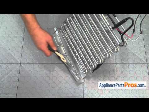

Jim D Tempe , AZ January 15, 2018 Appliance: Samsung Refrigerator RS2545SH/XAA Burned out refrig compartment defrost heater Took all shelves out. Removed cover over inside of back of refrig, the part with the fan in it. Disconnect wires as you go, they can only be reconnected one way so reconnecting is not a problem. You can only buy a complete evap assembly so you have to buy the whole assembly which includes the evaporator and the defrost heater. You bend some tabs and can remove the defrost heater from both the old and new parts. Then put the new defrost heater on the old evap. The one mistake I made was that I put the new defrost on a tiny bit off center.. make sure you get it centered. I had to cut off about an 1/8 inch of the styrofoam on the backside of the center panel so it would fit over the whole evap/heater assembly. I could have recentered the heater but I would have had to bend the aluminum tabs again and I didn't want to risk them breaking so I took the blacksmith approach. While I was in there I discovered that the air circulating fan had loosened from the motor shaft and was barely turning. I removed the fan blades completely and reinstalled it and pushed the tension coil spring back on real tight. All is working well. I tested the old heater by ohm meter and it should extremely high resistance indicating it was burned out. I also hooked it to 120 vac to see if it would heat up but it didn't. Warning, if you do this keep in mind that if the inside wires are burned (mine were but not quite burned thru) thru you could get 120 vac on the outside aluminum tube of the heater and get a nice shock. So proceed accordingly. I also put 120 to the new heater before installing to make sure it worked and it did. The "heater" on the inside is a long heat resistant multi strand string with resistance wire wound around it and all that covered with a flexible insulation. Mine had obviously overheated in several areas and cooked the insulation. In at least on area the resistance wire had burned up creating an open circuit. Read More... Do-It-Yourself Rating: Repair Time Estimate: 1-2 hours Tools: Pliers, Screwdrivers
Ricky M Spring , TX December 13, 2014 Appliance: Samsung Refrigerator RS267LBBP/XAA-0000 Fridge side was freezing up Bought the complete coil assembly, and separated the heater tube. Had to bend each tang that held the heater tube. Took some time, but honestly was not that big of a deal. Took a fill day to defrost before turning back on, as the drain port in the fridge was completely frozen. Not too mention a hidden block of ice in the fan assembly. Note: You want to keep the new lower metal tray, so you need a pair of snips or dikes to cut the single pop rivet. You don't have to re-rivet. Note2: The evaporator coils will bend a little, so you can work the new heater coils in, but be careful not to bend to much. Note3: The new assembly comes with two new sensors. It doesn't make any sense not to replace them as well. This of course, saved me the effort of paying a tech to sweat in the new evaporator. If you put wages to my time, I in no way saved money if you account for the hours, but if your strapped for cash, this is the way to go. Lots of folks are having this problem, but few, it appears, are using this method. They constantly have the same issue in a couple of months. That is, if they let everything completely defrost. I've manually defrosted 5 times before this repair, the last time not giving out enough time for all the ice to melt, it only lasted one month. Anyway folks, this is the way to go. Change the heater coil yourself. Read More... 30 People found this story helpful Do-It-Yourself Rating: Repair Time Estimate: 2+ hours Tools: Pliers, Screwdrivers

Kevin K Pensacola , FL April 11, 2016 Fresh food section was not cold enough freezer was normal I looked up the tech sheet & put it in self- diagnostic by holding LIGHTING & POWER FREEZE for 8 seconds. It displayed a special line code that I translated through the tech sheet (found online). It's suggested a bad heating element in the fridge. The sheet also said the resistance should read around 104 OHMS. I tested the wire harness at the control board and found the element had nearly 3000 OHMS. It needed to be replaced. Be very very careful handling the evaporator because it can crack at the seams & that will cost you a lot of money. The video here on APP was very helpful. Must watch! Read More... 2 People found this story helpful Do-It-Yourself Rating: Repair Time Estimate: 1-2 hours Tools: Pliers, Screwdrivers
