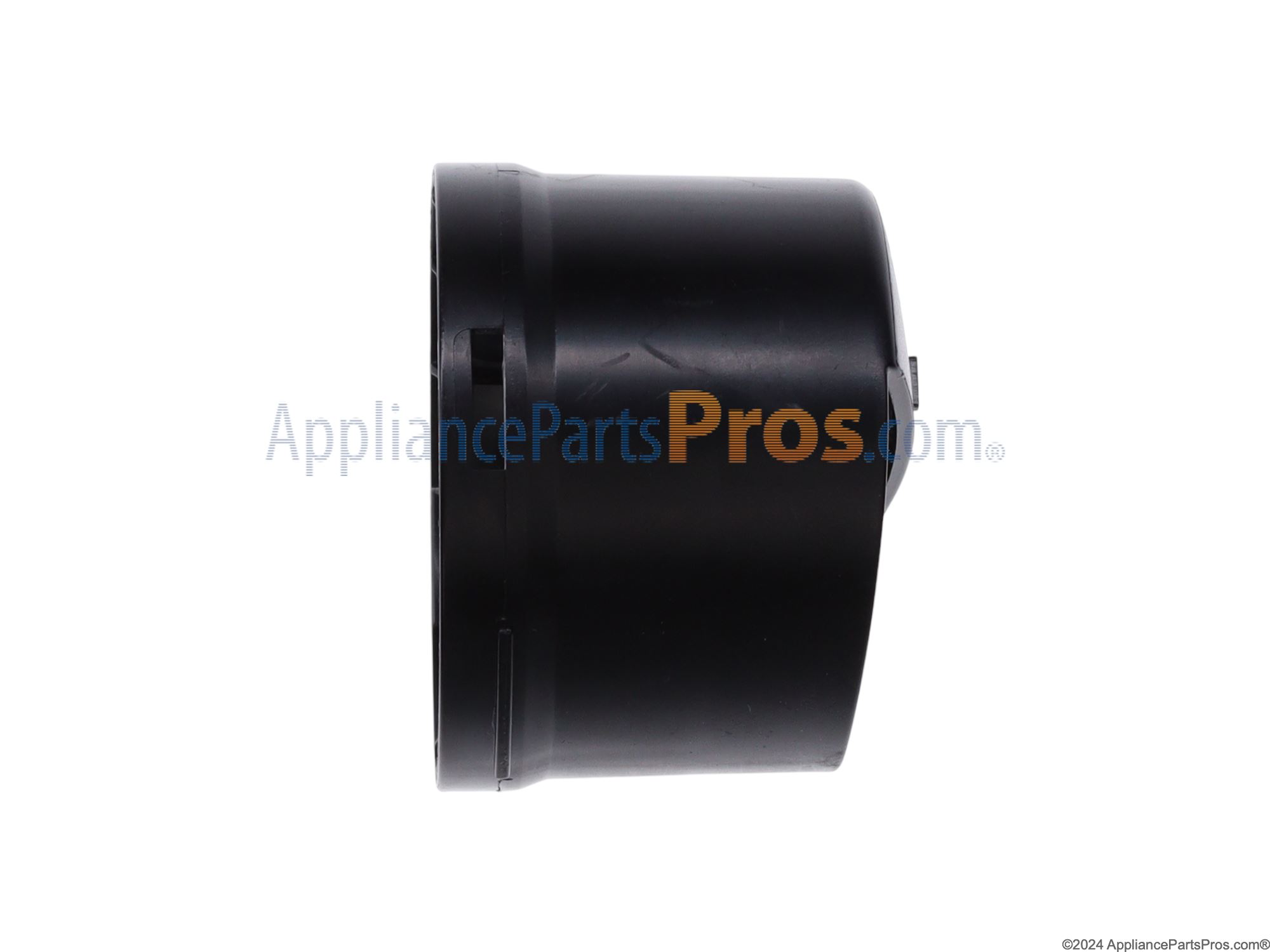

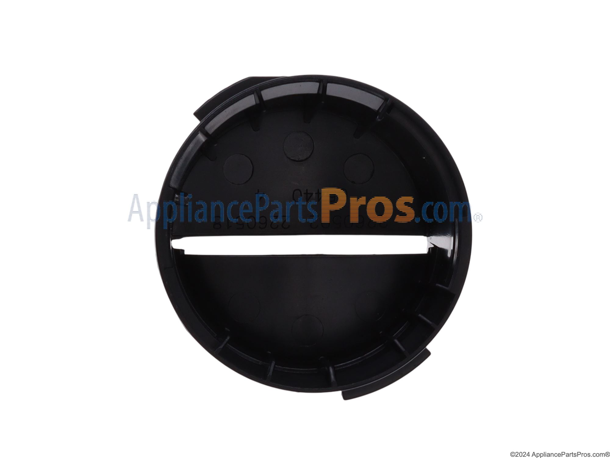

Carolyn H Metairie , LA February 08, 2015 The cap for the water filter was broken I order a new cap and was able to change the filter with no problem. Read More... 6 People found this story helpful Do-It-Yourself Rating: Repair Time Estimate: Less than 15 minutes
