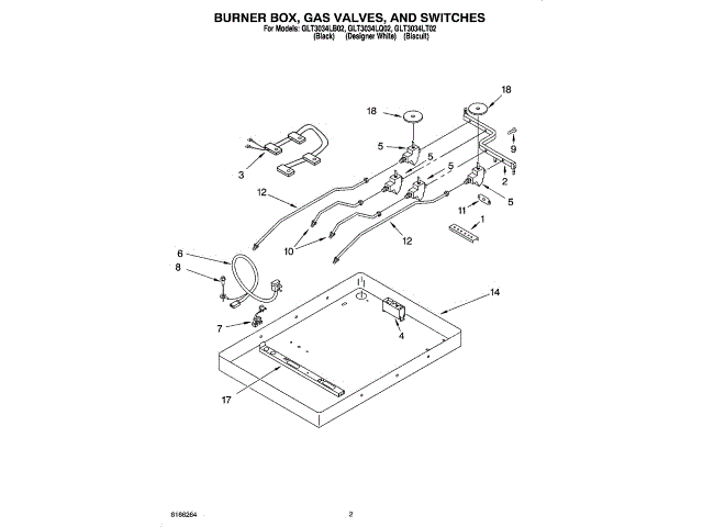

Raymond L The Woodlands , TX December 26, 2015 The front two electronic igniters on the stove top range stopped working I called a rpair service. The men came to the house, torn apart the stove top and advised Replacement of the wire harness. The trip charge of $100 would be deducted from a repair bill of $350, thus they needed an additional $150 for parts and $100 for labor after paying the trip charge. I bought the harness for $60, and the star bits I needed for my drill for $10. My son and I installed the new harness in about 30 minutes, which included a thorough cleanup, saving us $180. Read More... 4 People found this story helpful Do-It-Yourself Rating: Repair Time Estimate: 15-30 minutes Tools: Screwdrivers, Socket Set
Larry L Hillsboro , OR April 08, 2015 Cleaning the stove top from time to time if the amount of water that you use and allow to wet the harness below the knobs can damage the harness components so that the spark ignition will not function Changing out the harness wire solved the problem. Best practice is to shut down power and gas for safety. A little shot of WD-40 might help loosen the screws and make them easier to remove on the burners since I needed to take the glass top off of the metal box to replace the damaged harness below. The exploded diagram found on the parts order site was helpful to see where components are but a step by step instruction would have been better but a little tinkering around and eventually the process to resolve the issue came forth. A torx driver will be needed that is not listed in the tools used to remove the burner screws. Read More... 2 People found this story helpful Do-It-Yourself Rating: Repair Time Estimate: 30-60 minutes Tools: Screwdrivers, Socket Set
Victor D Glenview , IL February 23, 2015 Appliance: KitchenAid 30" Gas Glass Surface Cooktop KGCC506RWW01 When i clean stove i put a lot of water so one of the harnes was floded and exploud To change Harns and wire was very simple.Take 1 hr to do the Job.Customer service work grate. Thank you Read More... 2 People found this story helpful Do-It-Yourself Rating: Repair Time Estimate: 30-60 minutes Tools: Screwdrivers, Socket Set
Richard O Jackson , NJ December 19, 2014 One burner would not spark Purchased harness for spark and replaced the old harness. tools required was a star screw driver Read More... 1 People found this story helpful Do-It-Yourself Rating: Repair Time Estimate: 30-60 minutes Tools: Screwdrivers
Simon K Blaine , WA October 06, 2016 Appliance: Model ON THE BACK OF THE COOKTOP One igniter switch shorted to ground tried to open burner head (orif holder) but all screws rusted and broken and noway to remove from heads Ordered 4 Orif. holders and one set of switch, replace all damaged parts. Cooktop works fine now. Sale person Nathan S is very knowledgeable gave us good service. Read More... Do-It-Yourself Rating: Repair Time Estimate: 2+ hours Tools: Adjustable Wrench, Nut Drivers, Pliers, Screwdrivers, Socket Set, Wrench Set
