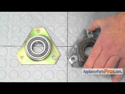

Sotirios P Placentia , CA October 16, 2014 Appliance: Amana Top Loading Washer LWA50AW Noisy washer due to bad main bearing assembly caused by water leak of the tub I decided to repair my Amana LWA50AW top loader washer because it has served us well, it is made by Speed Queen and an equal replacement is expensive. These are very dependable washers. The parts I ordered were: part #R9900552 (hub and seal kit) This kit does not include the Tub or Main bearing!!! Nor the drive belt!!! The main bearing is what is attacked by the water due to leaks and makes a jet engine sound as the tub spins faster and faster. Any way, the kit should be updated to include these items. My machine worked great besides the leak and noise. The repair is fairly simple as it is just disassembly and reassembly. A person with no DIU experience, might find this repair difficult but anyone with fair DIU experience should have no issues. No specialty tools are required but a large pulley puller and a pipe wrench or large udjustable wrench are needed and available at most auto parts stores, hardware stores and cheaper yet, at Harbor Freight. Do your research. Look at videos on YouTube specifically search "Speed Queen Transmission". This should give you a good idea. The pulley puller will be needed to remove the Drive Bell and the large wrench for the large nut. A hammer will be usefull if not needed here. I also used Permatex Ultra black gasket maker to seal the surface between the tub and the Seal. Don't worry, it will all make sense as you are taking it apart. When you do so, male sure to take pics and keep track of how things go back together. The tub is balanced by 6 springs. Those are tough to remove. I found it easier to remove the entire outer shell! It is very easy to do, held only by screws at the bottoms. then use a large wrench and pull them up and away from the tub. Same to put back on. Don't forget: unplug the washer, shut off water supply, remove front Panel, remove entire top with lid (2 screws at each front corner, that's it) then remove the two pipes from the water pump. When you have removed all the parts from inside the tub, flip it upside down now you will have easy acces to the motor, transmission. The pump must come off for the belt to go on. Allow the sealant you used to dry overnight before starting a load. Hope this helped someone! Good luck! Read More... 72 People found this story helpful Do-It-Yourself Rating: Repair Time Estimate: 2+ hours Tools: Adjustable Wrench, Nut Drivers, Pliers, Screwdrivers, Socket Set, Wrench Set
Robert B Grand Rapids , MI November 12, 2016 Appliance: Amana Top Loading Washer ALW880QAC1 My amana washer was very loud during the spin cycle I replaced the main bearing on my Amana washing machine but it was a total nightmare. The repair video was priceless as I never would have even tried to fix it myself without it. I couldn't remove the agitator or the drive bell cap but I had a helper with muscle who removed both. It saved me from buying removal tools. I broke off the four bolts holding the inner tub to the hub. I tried cleaning the four extra holes in the hub with Q tips and cleaner but broke off two bolts reinstalling new bolts so I took the hub to a machine shop and they drilled out the two bolts and tapped the holes again. I installed a new spline insert as recommended by the manufacturer with the fingers up after installing the 11/4 inch nut but the drive bell upper seal could not be pressed down over the top of the fingers so we put the spline on the shaft with the fingers up and then put the 11/4 nut on over the spline with the nut inverted (flat side up) so the base of the spline would fit in the inside hollowed part of the nut. This is the way it was done on another video even though it comes from the factory with the spline put on the shaft after the nut. Now we were able to get the drive bell seal over the spline but we were unable to press it down further then 3/16 inch from the base lip so I ordered the installation tool 293p4 and we still couldn't get it down any further hammering it with a block of wood. I guess it is not supposed to go down more than 3/16 inch from the base lip so that is how we left it. If I were to do this alone I don't think I could have gotten the drive bell seal on at all as my helper pressed it on with all the strength he could muster and he is much stronger than I. Read More... 20 People found this story helpful Do-It-Yourself Rating: Repair Time Estimate: 2+ hours Tools: Adjustable Wrench, Pliers, Screwdrivers, Socket Set, Wrench Set
Joel H Chicago , IL August 27, 2017 Appliance: Amana Top Loading Washer ALW480DAW Loud noise during spin cycle While I suspected the main bearing was the source of the noise, I did pay to have a service professional check it out. He confirmed that was the issue, but the cost to replace was pretty high. Even though he did not recommend this as a DIY project, after watching the video, I though it was definitely worth a try. I'm glad I did. The machine is working normally again. As one user shared, he would not have attempted this had it not been for the video and I agree. I had the video at my side the whole time and played and paused as I went along. Things I learned or that were different from the video. -Definitely move the machine to an area where you have space to easily get around all sides of the machine and to layout the parts as you disassemble. -Remove the entire cabinet, not just the front panel. This will make it much easier to reach the transmission pulley and the back springs. This will require removing the top entirely, which will require some additional wire disconnects and doing things in a slightly different order than the video. One reason I went this route was that when I raised the top it would not stay in a semi-upright position like in the video. If I let it fall all the way back it would have bent the tabs where it is attached to the cabinet and probably the cabinet as well. So since I already had the top off, it was easy to remove the sides as well. The three sides come off as one unit. -When working with the motor, disconnect the two front springs from the basin. This will allow you to tip the basin back slightly which will give you easier access and provide more clearance for taking it out and putting it back in. Also, if you can, attach the wire harness before you bolt the motor in place; otherwise, you're working somewhat blind. -For the step where you need to set the outer basin on two supports, I used two empty 5 gallon pails upside down. Worked perfectly. These are the kinds of pail you can get at Home Depot or Menards. -In the video, you are told to remove two 5/16 screens that attach the counter weight to the basin. Mine did not have these, so I skipped this step. But I couldn't get the shaft to budge from the basin. Turns out, the counterweight was attached with two bolts that are accessible from the bottom of the basin. When you put the outer basin back on the transmission unit, you will see the holes in the bottom. Make sure they line up with the holes on the counter weight. -I also couldn't see the plastic spline on the shaft and so thought maybe there wasn't one. But there was, I just need to clean things up. Once I removed the spline, and the bolts attaching the counter weight to the basin, it only took a few hits for things to start to loosen up. -I didn't have a pipe wrench and small sledge, so tried it without them. Didn't work, so purchased them. Definitely needed those two tools. -The front of my machine consists of two panels. The upper panel, I found, helps hold the cabinet together. So if you need to move the unit back into place to test, make sure you have put this back on. If it's not attached, the cabinet starts to bend when try to push it back. Read More... Do-It-Yourself Rating: Repair Time Estimate: 2+ hours Tools: Adjustable Wrench, Nut Drivers, Pliers, Screwdrivers, Socket Set
Jason C Alva , OK November 20, 2014 Appliance: Amana Top Loading Washer DLW330RAW Main bearing going out All the talk of a loud washer sounding like a jet taking off in the laundry room, well this is the fix. Kind of a complicated repair but just follow the instructions and you'll breeze right through it. Figure if you're about to tear into a washing machine and DIY you got this handled. Get the washer to a wide open room, I used the garage, and take the whole thing apart. Don't try to fix it with the side panels attached, it will be a pain in the butt. There are a few special tools needed but if you're clever you can work around that. A deep 1 1/2" socket and driver will come in real handy, otherwise you'll need a special tool to remove the main nut holding the whole project together. Make sure you get the hub and seal kit along with the bearing because you'll need it. Had mine torn apart and put back together in a little over three hours, but there were a few adult beverages involved to make things go smoother Read More... 32 People found this story helpful Do-It-Yourself Rating: Repair Time Estimate: 2+ hours Tools: Adjustable Wrench, Nut Drivers, Pliers, Screwdrivers, Socket Set, Wrench Set
Leslie B Green Valley , AZ August 01, 2015 Appliance: Model LW5163WM Very rough spin cicle Replace bearing. This was a veryy involved job since I had to disassemble the entire washing machine. Since previously I purchased a seal kit, it came in handy for this repair.Machine is much quieter now. Read More... 7 People found this story helpful Do-It-Yourself Rating: Repair Time Estimate: 2+ hours Tools: Adjustable Wrench, Pliers, Screwdrivers, Socket Set, Wrench Set
