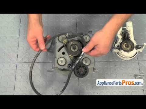

Corey C Wadsworth , OH July 22, 2014 Appliance: Model AMANA WASHER Replacement of belt after overloading Repair is relatively simple. Unplug washer, remove motor carriage, 4x1/2" bolts, then unplug motor and take belt off of pulley under wash tub. Remove 3 torx bolts securing pump, then pull pump off. Removing the pump isn't easily done without tools, but it can be done. Prying it off the motor with tools may damage it. Once the pump is off, replace the belt and put it all back together. Read More... 25 People found this story helpful Do-It-Yourself Rating: Repair Time Estimate: 30-60 minutes Tools: Screwdrivers, Socket Set, Wrench Set

Donald B Fredericksburg , VA June 30, 2015 Appliance: Maytag Top Loading Washer SAV205DAWW Maytag sav205daww washer [2004] was leaking and drive belt kept falling off the idler pulley Ordered a new pump, belt and idler pulley from AppliancePartsPro. Removed the 4 mounting bolts on the motor/pump assembly and removed the hoses from the pump, then tilted the motor to expose pump and belt. Removed 3 mounting screws (torx) from pump and pried the pump loose (some effort with short pry bar and screwdriver). Removed retainer c clip from idler pulley axle, removed old pulley, installed new pulley and c clip. Positioned moter/pump assembly and bolted it up. Positioned new belt on drive pulley, idler pulley and agitator shaft of washer. Read More... 9 People found this story helpful Do-It-Yourself Rating: Repair Time Estimate: 30-60 minutes Tools: Pliers, Screwdrivers, Socket Set
