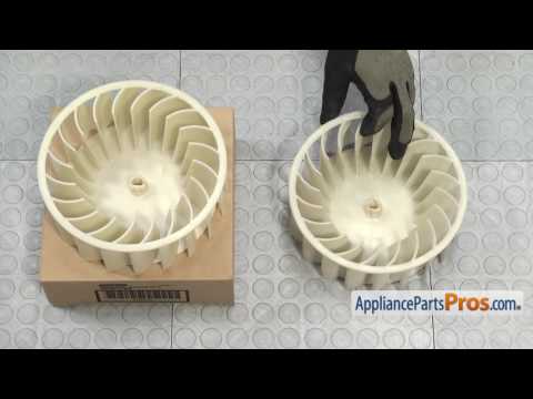

Teresa A Purcellville , VA March 11, 2016 Broken blower wheel (toy dropped inside and crushed the blades) After watching a few videos, I opened the front of the dryer, removed the old pieces and put in the new ones. This model of dryer was pretty easy to work with. One thing that I didn't expect to be so difficult was the removal of the old blower wheel. The new one slid right on, but the old one didn't want to budge without a lot of force. If you can go ahead and get the special snap ring pliers, it would definitely make it easier to get the snap ring off and on, but I did the repair with a set of tweezers. I recommend wearing work gloves--I got a few nicks on my hands while doing the repair. Read More... 5 People found this story helpful Do-It-Yourself Rating: Repair Time Estimate: 15-30 minutes Tools: Nut Drivers, Pliers, Screwdrivers
S M Bayville , NJ June 10, 2015 My clothes dryer was making a really loud noise Inspected inside of dryer parts and saw that the dryer blower wheel was cracked. Called a major department store to order part and was told it would take almost 2 weeks to be delivered to the store. I looked the part up on line and found AppliancePartsPros.com. I ordered the part on line on Tuesday and it was delivered to my door on Thursday! It also cost me less than it would of if ordering it through the store including shipping and handing. Luckily I have a handy son in law who was able to do the repair and my dryer sounds like new even though it is over 10 years old and for a total cost of $26.92! I would definitely recommend this site for its reasonable prices, ease of placing an order, and fast delivery and would not hesitate to contact AppliancePartsPros again if a need arises in the future Very Satisfied Customer Read More... 3 People found this story helpful Do-It-Yourself Rating: Repair Time Estimate: 30-60 minutes Tools: Nut Drivers, Pliers, Screwdrivers
