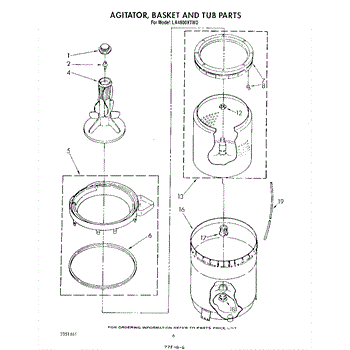

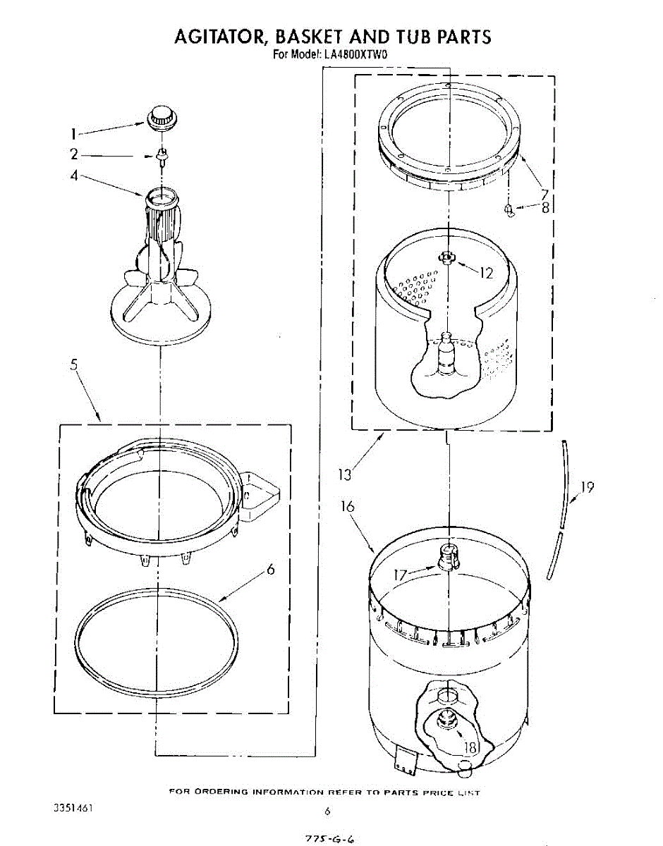

Parts for Whirlpool LA4800XTW0: 04 - Agitator, Basket And Tub Parts
