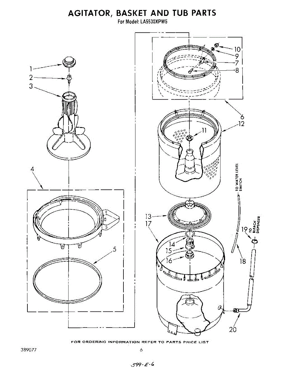

Parts for Whirlpool LA5530XPW5: 04 - Agitator, Basket And Tub Parts
