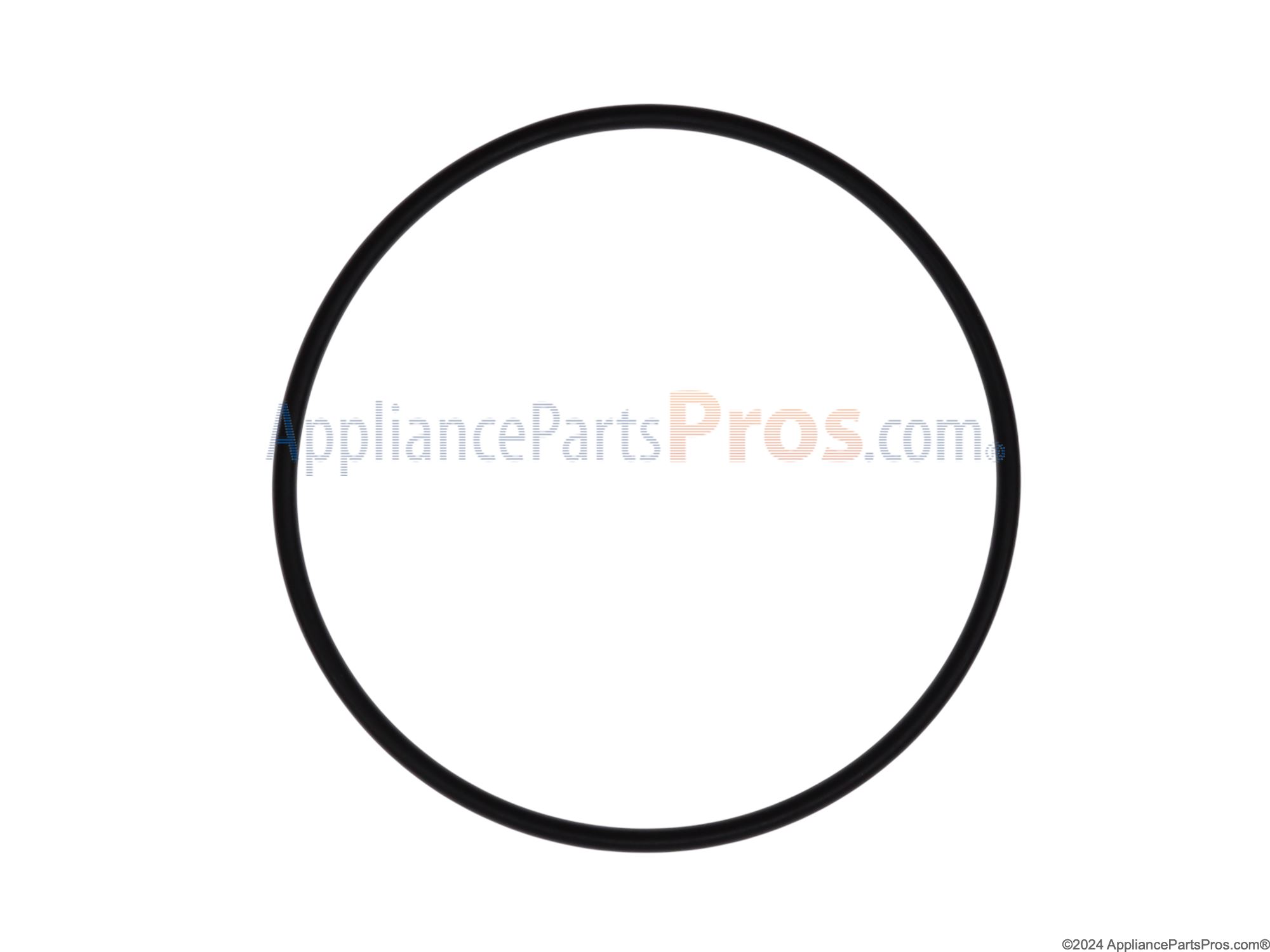

Sarah R Austin , TX January 29, 2023 Appliance: Bosch Dishwasher SHE68T55UC/07 E15 error code "Watertap" E15 error code indicated leaking. Dried it all out to allow it to run again. Ran dishwasher with front and bottom panels off to get a visual on leak causing the styrofoam float to set off the code. Saw it was coming from the diverter area. Ordered this assembly -- which DOES include the seal ring, by the way -- pulled dishwasher all the way out to replace it, and VOILA. No more leaking or error code. (This took a few days to analyze and receive the part, so in the meantime we were able to run the dishwasher during the day with the door and bottom panel off as long as we monitored the leak and kept some paper towels down there to soak it up.) Read More... 14 People found this story helpful Do-It-Yourself Rating: Repair Time Estimate: 30-60 minutes Tools: Adjustable Wrench, Screwdrivers

Gary W Tacoma , WA April 19, 2025 Appliance: Bosch Dishwasher SHE68T55UC/03 Bosch dishwasher diverter valve Watched the repair video available on the website. VERY HELPFUL. I think I would have been very frustrated without the steps shown in the video and how it showed how to disassemble to get to the diverter valve. My diverter valve was leaking and triggered the error code. The common failure is the o-ring but one I removed the diverter valve, I noticed the leak was from the valve shaft not the o-ring. I replaced the diverter valve with the new one. I ran into difficulty reinstalling the valve. I could not get close to engaging the bayonet mount due to placing the o-ring on the diverter valve assembly. After placing the o-ring on the sump assembly first, the valve reattached easily. Reassembly was easy and without the o-ring difficulty, I would say the dishwasher was back up and running in less than 2 hours. Read More... Do-It-Yourself Rating: Repair Time Estimate: 1-2 hours Tools: Adjustable Wrench, Screwdrivers
